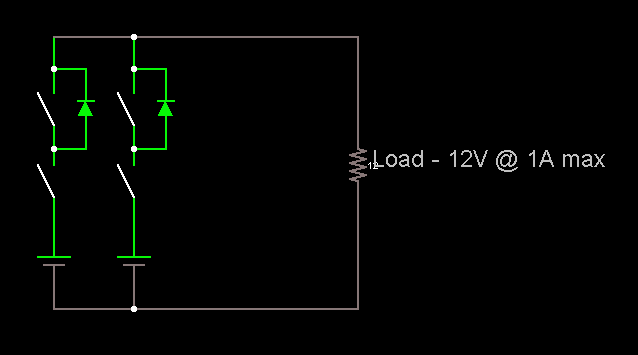

I think I'll just go with a double light switch setup so I can switch the new battery on and then the old one off to take it away for a recharge..
Put a diode in parallel with each switch. When you're ready to swap batteries turn both switches off. When the swap is complete turn them back on.
Also, it might be more convenient to use just one double pole switch.

I think you misunderstood my post.
This is the same as your original idea of using two diodes except the switch will eliminate the .6v drop during normal operation. And when swapping batteries it will eliminate the possible large current flow from one battery to the other. Since you said in a previous post:
Why not just stick the diodes in there?

Turtles idea will work well, you can also look for a changeover switch (SPSO) and have the diodes in parallel with each side of the switch - this will prevent both batteries from being hard connected at any time.
Actually that's a very good idea now you've explained it that way. I like it. I apologise for being abrupt towards you previously, I didn't think you understood the issue. Clearly you had a better understanding than I realized and you were one step ahead of me. Please accept my sincere apologies.

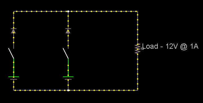

This is what I'd originally been thinking:
I like your method and now I'm thinking I should go with it. As you can see from mine, it would have dropped about 0.7V from either battery (although using a car battery which is at 13.5v when full that may not be such a bad thing).

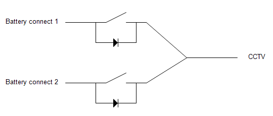

I noticed a safety issue with my method that you should be aware of. When connecting the battery, there will be a current flow of up to one amp. That is not much, but it may be enough to cause a spark at the battery terminal. If the battery is being brought straight from the charger, there is a chance that the spark could cause a battery explosion due to hydrogen gas build up. The best solution would be to add a series switch in addition to the one in parallel with the diodes (combining my idea with yours). In your diagram, just add a switch in parallel with each diode. That way you can connect the battery, then flip the series switch, causing the spark to occur at the switch instead of the battery terminal.
So by that do you mean like this?:

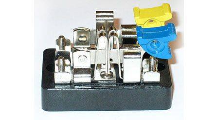

Here's what a double pole one looks like; which I think you should use.
Yes, that's it.

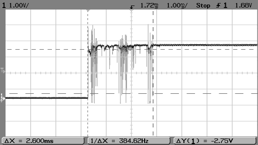

Dixo said:
Just out of interest, in a car do all the switches spark internally then?
Yes. Switch and relay contacts will spark on make and break. The degree of sparking depends on the voltage, current, and switch design. Explosion-proof switches are available for hazardous locations. These are basically normal switches housed in sealed flameproof blocks.
And they make and break more than once when you flip the switch.
Contact Bounce
