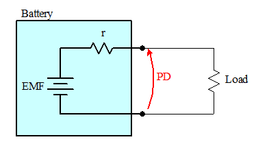

Explain why the PD between the terminals of a cell is not always the same as its EMF.
A cell, a resistor and an ammeter of negligible resistance are connected in series and a current of 0.80 A is observed to flow when the resistor has a value of 2.00 Ω. When a resistor of 5.00 Ω is connected in parallel with the 2.00 Ω resistor, the ammeter reading is 1.00 A. Calculate the EMF of the cell.
Answer: 2.29 V.
2. The attempt at a solution
I did a quick illustration of the problem, as I see it:
So, on the first (I) graph we have V = I R = 0.8 * 2 = 1.6 V. Second (II): we find the resistance 1 / R = 1 / 2 + 1 / 5 → R = 1.43 Ω. So V = I R = 1 * 1.43 = 1.43 V.
I guess it has something to do with the cell and EMF differences. As far as I know, their difference is in the fact that PD is work done to move a charge between two points in a circuit and EMF is the total work done to move charge throught a complete circuit. And the formula is also different: V = I R, (R = total resistance), E = I (R + r), (R + r) = total external and internal resistance.
What am I missing?

I'm trying to point out that real world components (all of them) have flaws that when examined closely make them non-ideal. Even batteries. Your diagrams are fine.
What you need to do is account for the possibility that the battery is not an ideal component.
Likes moenste

The battery is non-ideal. You should consider its internal resistance.

So the PD of a cell is considered to be an ideal case while the EMF is not ideal. This is the case with:
E = I (R + r)
Let's find r, the internal resistance: 0.80 A (2.00 Ω + r) = 1.00 A (1.42857 Ω + r) → r = 0.857 Ω.
Plug it in: E = 0.80 A (2.00 Ω + 0.857 Ω) = 2.29 V.

Emf is the open circuit terminal voltage of the battery. If Pd=Emf for any value of current, that would be an ideal case.

The voltage of a cell when no current is being drawn is sometimes called the Thevenin voltage. A cell can be conceptualized as an ideal* voltage source in series with a Thevenin resistance.
* Voltage doesn’t drop under load.

The PD is what you would measure at the terminals of the battery under whatever load conditions there might be. It varies with the load (amount of current being drawn).
The EMF is the potential difference that is attributed to the underlying source of electric potential. Typically it is a chemical cell of some sort whose reactions separate charges to some fixed potential difference. It's what you would measure for the PD when there is no load (no current).

PD = EMF + internal resistance does not pass dimensional analysis muster:
(voltage = voltage + resistance).
All terms in an equation must be the same physical quantity:
PD = EMF – (current x Thevenin resistance)
