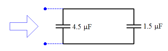

When you have just two components connected in a closed circuit, whether to treat them as series or parallel connected can be a bit ambiguous. In fact, such a connection satisfies both the definitions of series connection and parallel connection! That means that you can treat them as either series-connected or parallel connected, whichever is most convenient for your analysis at the time.
One caveat that you should be aware of is that sometimes a given problem will implying that you need to look at a circuit from a particular point of view, that is, you should judge the circuit from the point of view of a certain pair of nodes (connection points). In such a case that may force your interpretation of the connection as being series or parallel. In your second problem the implication of wanting to know the potential across both capacitors implies that you should construe the circuit in the following way:
so that the parallel connection of the capacitors is the preferred interpretation. You could also treat them series-connected and solve for the potentials across the capacitors separately (and find out in the end that they are equal), but it's a lot more work to do it that way!
One way to identify whether two components are in parallel is whether you are able to trace a closed path through those components without having to pass through any other circuit component. If you can, then they are parallel-connected. If you cannot, they are not parallel-connected.
