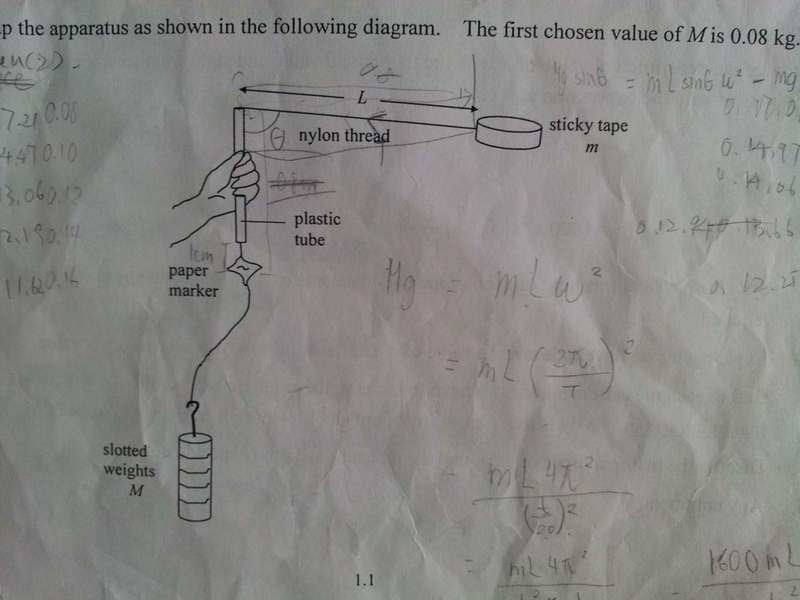

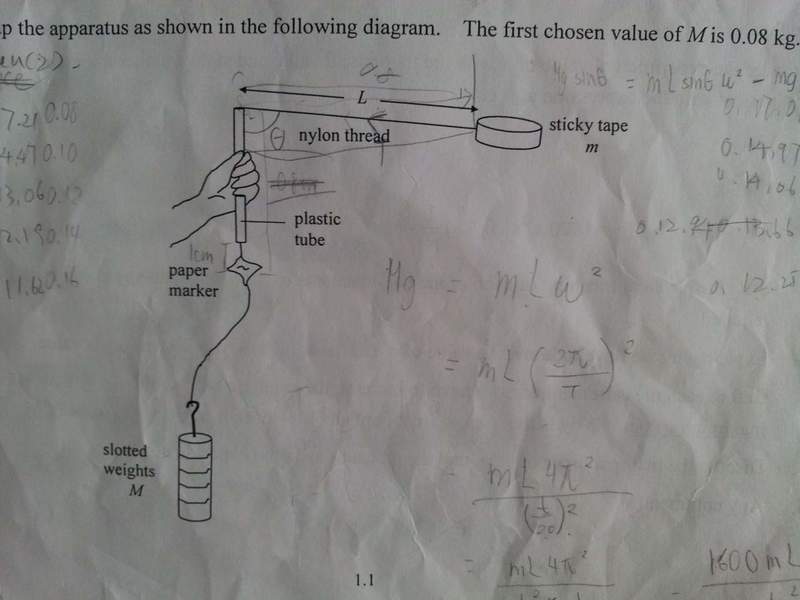

In summary, the equation Mg=[1600∏2m(L+a)(1/t2)]- b represents an experiment to verify centripetal acceleration using a plastic tube, sticky tape, and slotted weight. The constants a and b account for the radius of the tape and static friction in the tube, respectively. To determine the value of g, a suitable graph can be plotted by setting M as the y-axis and a function of t as the x-axis. The reason for increasing the angular speed to a maximum value is related to the value of b, which represents the opposing force of centripetal acceleration.
michellelamcc
M is the mass of the slotted weight
g is the gravitational force
m is the mass of the sticky tape
L is the length of the nylon thread measured from the end of the plastic tube to the sticky tape
t is the time for 20 revolutions of the sticky tape
a and b are constants
Excuse me, I would like to ask:
1. What are the physical meaning of a and b ?
2. How can I plotted a suitable graph to determine the value of g based on these datas?

It's an experiment to verify centripetal acceleration= rω2
Producedures:
1. Set up the apparatus as shown in the photo.
2.Hold the plastic tube vertically and whirl the sticky tape above your head in a horizontial circle.Increase the angular speedof the sticky tape to a maximum value such that the paper marker still remains stationary at the position 1cm below the lower end of the plastic tube.Keep the tape roating at that particular speed throughout the motion.
3. Mesure the t for 20 revolutions of the t.
4. Repeat the prodcedures by using different mass of M.

My work:
Fc= mrω2
Mg= mL4∏2 / (t/20)2
= 1600mL∏2 / t2
And I don't know why there are a and b :(
Looks like a is to account for the radius of the tape. L is not the distance to its centre. 'a' should be slightly more than the radius.
'b' may be allowing for some static friction in the tube.
In the OP you said it was to verify the rω2 formula for centripetal force.
That means you need to show that there are values for a and b which make the observations fit well.
If you plot M (as y) against a suitable function of t as x you should get a straight line. What function of t?

There are some hint in the questions.
It asked that why we hv to increase the angular speed of the tape to a maximum value, and how does it releate to the value of b?
i agree with solution of haruspex.the constant b is the static friction of the plastic tube which is opposing the centripetal acceleration.Hence it is adding to the Mg .
I also agree with that ^^
michellelamcc said:
Thank you for your answer
But sorry, I don't quite understand the meaning of " What function of t?" ><
If you were to plot M against t then, according to the equation, you would not get a straight line. So instead you want to plot M against some function f(t) of t. If this is to produce a straight line then you want the equation to be the same as M = α f(t) + β for some constants α and β. Can you find f, α and β?
