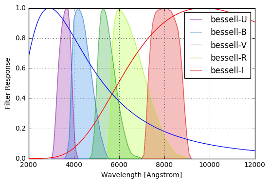

Hi, in determining the temperature of stars using colour index (U-B,B-V,V-R, etc), why do we need to use the appropriate pairs of filters based on their range of temperature? (this is what i read from wiki)
For cool stars, we use R-I, and for hotter stars, we use B-V. I don't understand how using different pairs of filters make a difference because isn't radiation curve of blackbodies with different temperature have different shape and thus, the values of (B-V, U-B, V-R) will also be different? (I hope you understand what I'm trying too say)
My idea is this has to do with the star's peak wavelength...but i still don't see the justification to that...
your help would be greatly appreciated

I'm betting that astronomers use the R-I filters instead of the B-V filters for cooler stars so that you don't block out most of the light. Cool stars don't put out much visible light in the higher frequencies, so using a bandpass in the red-infrared range makes them easier to see and measure.

Right. Look at this plot showing the filter bandpasses with a 3000 K (red) blackbody and a 10,000K (blue) blackbody. You can see that the hot blue star doesn't have much light in the I band, and the cool red star doesn't have much in the B band.

but the question is, why does it affect the accuracy of temperature calculated based on the star's U-/B/B-V/V-R?? because we're just going to get either lower or higher values of B-V, V-R, R-I which correspond to temperatures. I mean for cooler stars, we already expected their U-B will be low. so, it shouldn't be a problem to determine their temperature based on the U-B value. Isn't the accuracy going to be just the same if we determine the temperature using R-I filters? (i hope you understand my question)

The lower the light intensity, the fewer photons there are to measure and the lower the accuracy. If you take a star, which is dim to begin with, then add a filter that removes most of the photons, you can end up with a surprisingly small number of photons. Since the photons are distributed according to a Poisson distribution, the error goes down as 1/(sqrt(N). So the more photons you have, the smaller the error.
