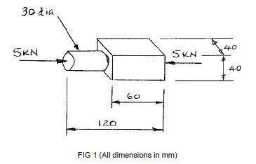

Hello this is my first post here so basically I've had my best crack at all the questions all I am really after is a bit or re assurance as to my answers and if any are wrong were I have gone wrong essentially. I've tried to include all my working out were possible.
1. Homework Statement
The component shown in Fig 1 is made from a material with the following properties and is subjected to a compressive force of 5kN.
Material Properties :
Young’s Modulus of Elasticity – 200 GNm - 2
Modulus of Rigidity – 90 GNm - 2
Poisons ratio – 0.32
2. Homework Equations
Calculate :
(a) The stress in :
(i) the circular section
(ii) the square section
(b) The strain in :
(i) The circular section
(ii) The square section
(c) The change in length of the component
(d) The change in diameter of the circular section
(e) The change in the 40mm dimension on the square section
(f) If the same component were subjected to a shear force of 7 kN as shown in FIG 2, calculate the shear strain in :
3. The Attempt at a Solution
Calculate :
(a) The stress in :
Stress = Force / Area
Area of circular section = πr2
π(15)2 = 706.8583mm2
Answer : Stress = 5000 / 706.86 = - 7.07MPa
Area of the square section = length x height
40 x 40 = 1600mm2
Answer : Stress = 5000 / 1600 = - 3.125MPa
(b) The strain in :
ε = dl / l0 = σ / E
σ = F / A = 7.07MPa
E = 200GN / m - 2 = 200000MPa
7.07 / 200000 = 0.00003535
Answer: Strain = - 3.535 x 10 - 5
ε = dl / l0 = σ / E
σ = F / A = 3.125MPa
3.125 / 200000 = 0.000015625
Answer: Strain = - 1.5625 x 10 - 5
ε = dl / l0
For the Cylinder Section
ε = 3.535 x 10 - 5
l0 = 60
dl = ε x l0
dl = 3.535 x 10 - 5 x 60 = 0.002121
= - 2.121 x 10 - 3
For the Square Section
ε = 1.5625 x 10 - 5
l0 = 60
dl = ε x l0
dl = 1.5625 x 10 - 5 x 60 = 0.005625
= - 5.625 x 10 - 3
Adding the two changes together
- 2.121 x 10 - 3 + - 5.625 x 10 - 3
= - 0.007746
Answer Change in Length = - 7.75mm
Change in Diameter = - original diameter x poisions ratio x (Change in length / Original length)
- 30 x 0.32 x ( - 7.75 / 60 ) = 1.24
Answer Change in diameter = 1.24mm
Poisions ratio (v) = εx / εz = - εy / εz
εx = εy = - vεz
= - 0.32 x -1.5625 x 10 - 5
= 0.000005
Δx = εxx0 = 0.000005 x 40 = 0.0002
Δx = εyy0 = 0.000005 x 40 = 0.0002
Answer Change in dimension on the square section
= 2 x 10 - 4

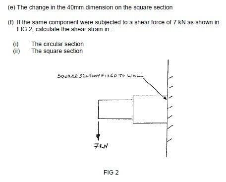

Stress = 7000 / 706.86 = 9.9029MPa
Shear Strain = Shear Stress / Modulus of Rigidity
Modulus of Rigidity = 90GN/m - 2
= 90000MPa
Shear Strain = 9.9029 / 90000 = 1.1003 x 10 - 4
Answer Shear Strain = 1.1003 x 10 - 4
Stress = 7000 / 1600 = 4.375MPa
= 90000MPa
Shear Strain = 4.375 / 90000 = 4.86 x 10 - 5
Answer Shear Strain = 4.86 x 10 - 5
