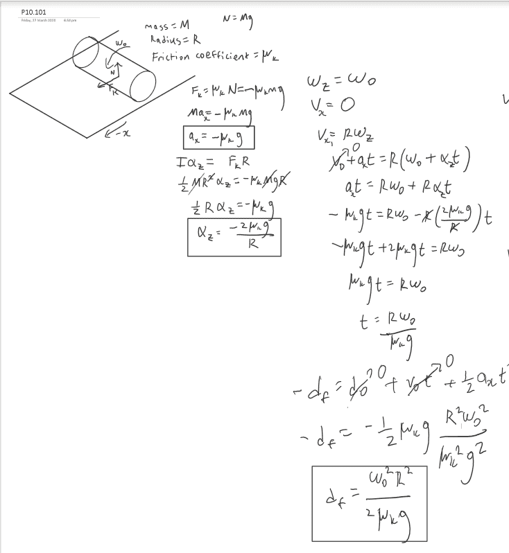

A solid cylinder with mass M and radius R, rotating with angular speed about an axis through its center, is set on a horizontal surface for which the kinetic friction coefficient is (a) Draw a free-body diagram for the cylinder on the surface. Think carefully about the direction of the kinetic friction force on the cylinder. Calculate the accelerations of the center of mass and of rotation about the center of mass. (b) The cylinder is initially slipping completely, so initially but Rolling without slipping sets in when Calculate the distance the cylinder rolls before slipping stops
Kinematic equations
I'm not sure as to why my working is incorrect. When the sign on [itex]a_x[/itex] is postive, i get [itex]t = \frac{R\omega_0}{3\mu_kg}[/itex] which would give the correct value for distance if plugged into the kinematic equation. However, I'm not sure why [itex]a_x[/itex] would be positive though since the friction force is pointing in the direction of -x
Working:
In your hand-drawn solving, you write an equation:$$-d_f=d_0 + v_0t + \frac{1}{2}a_xt^2$$Can you justify that equation? Why the minus sign on ##d_f##?

No what i meant was the sign on [itex]a_x[/itex] changes the value of t and i do not know why the sign should be positive even though friction is pointing in the -x direction.
Well, let us review how you are calculating t. It seems that we will have to decode some chicken-scratchings.
You start with$$F_k=\mu_kN=-\mu_kmg$$At this point you have inserted a sign into the formula because the relative motion of the ground beneath the cylinder is leftward -- in the direction of negative x. I agree. Because the only force acting is ##F_k##, you invoke Newton's second law (##F=ma##) and assert that$$ma_x=-\mu_kmg$$. A straightforward inference. I agree. You divide out the m to obtain$$a_x=-\mu_kg$$You now shift to angular momentum and assert that equate the rate of change of angular momentum with the applied torque:$$I\alpha_z=F_kR$$Here you are implicitly adopting a sign convention such that ##\alpha_z## is positive counter-clockwise. You proceed to substitute in for the moment of inertia ##I=\frac{1}{2}MR^2## and ##F_k=-\mu_kmg## to obtain$$\frac{1}{2}mR^2\alpha_z=-\mu_kmgR$$You are a bit sloppy with the case on the M versus m, but you cancel it anyway along with one factor of R to obtain$$\frac{1}{2}R\alpha_z=-\mu_kmg$$You proceed to solve for ##\alpha_z## obtaining$$\alpha_z=\frac{-2\mu_kg}{R}$$I agree with this and agree that the sign on the resulting angular acceleration will be negative (i.e. clockwise).

The equation that matters is $$v_0+a_xt =R(\omega_0+\alpha_zt)$$This is supposed to be the rolling without slipping equation. But let us examine it for sign convention agreement. On the left hand side we have the velocity of the cylinder with a sign convention of right = positive. On the right hand side we have the rim speed of the cylinder with a sign convention of counter-clockwise positive. But that does not fit. A positive (rightward) velocity without slipping means a negative (clockwise) roll rate.
There's your sign error.

Ah i understand now. Thank you
