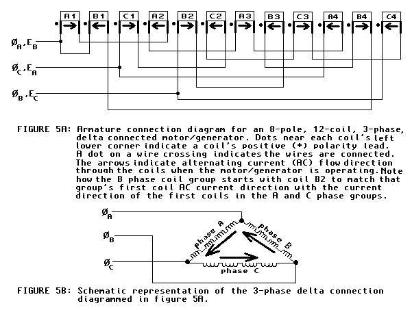

i want to make a delta 3 phase system.
Now, i know how i need to wire everything together, but i have a few questions.
the plan is to have A B C and have 4 coils each and i would hook it up like this. A1 -> A2 then A3, A4, C1, C2, C3, C4, B2, B3, B4, B1 goes back to tie into A1. like this
Now, the part where A meets into C, do i need anything special or do i just wind them together?
Also, how do i take it from having 3 wires (A, B, C) down to two, just + and -?
