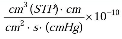

Latex balloons do well to last a day, helium is so tiny it just goes straight through. you can buy an additive to add to latex balloons called Hi-float that makes them last a few days but never a year. The helium can definitely go through the mylar ( I have a permeability coefficient of 4.2-20x10^-10 ) Why else would all food packaging etc have ALU if it isn't to reduce permeability. It certainly adds cost.
The units I quoted are
