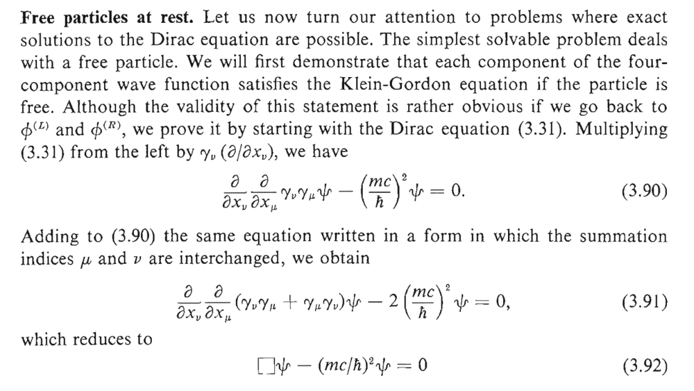

In Sakurai's book "Advanced QM", he writes the Dirac equation (equation 3.31 to be exact) as: $$\left(\gamma _\mu \ \dfrac{\partial}{\partial\ x_\mu} + \frac{m\ c}{\hbar}\right) \ \psi= 0$$ which we can write as $$\left(\gamma _\mu \ \partial ^\mu \ + \frac{m\ c}{\hbar}\right) \ \psi= 0$$
Next, we go to the section 3-3, and subsection "Free particles at rest".
The author multiples the Dirac equation from the left by ##\gamma _\nu \ \partial ^\nu##. We get the form $$\left[ \partial ^\nu \ \partial ^\mu \ \gamma_\nu \ \gamma_\mu \ - \left(\frac{m\ c}{\hbar}\right)^2 \ \right]\psi = 0$$ If we interchange the indices ##\mu## and ##\nu##, and add to the above equation, we get $$\left[ \partial ^\nu \ \partial ^\mu\ \left( \gamma_\nu \ \gamma_\mu + \gamma_\mu \ \gamma_\nu\right) \ - 2 \ \left(\frac{m\ c}{\hbar}\right)^2 \ \right]\psi = 0$$ which reduces to $$\Box \ \psi - \left(\frac{m\ c}{\hbar}\right)^2 \ \psi = 0$$ using the anticommutation relations of the ##\gamma## - matrices.
Till now, I have just quoted from the book (except changing the ##\partial / \partial x_\mu## to ##\partial ^\mu##).
I knew the D'Alembertian operator to be ##\partial ^\mu \ \partial _\mu##, but Sakurai seems to be suggesting that it is ##\partial ^\mu \ \partial ^\nu## instead. The two can be related: $$\partial _\mu \ \partial ^\mu \ = \ g_{\mu \nu} \ \partial ^\nu \ \partial ^\mu\ ,$$ but that's not what the author has written. What am I missing?
Here is a picture of the page:

One of the properties of ##\gamma## matrices is $$\left\{\gamma^\mu,\gamma^\nu\right\}=2g^{\mu\nu}$$
Likes vanhees71, atyy and Wrichik Basu
Thank you, that perfectly solves the problem.
I don't know why Sakurai is reluctant to use the metric tensor. He just writes ##\{ \gamma_\mu , \ \gamma_\nu \} = 2 \delta _{\mu \nu}##. In fact, in chapter 1, he says,
Note that we make no distinction between a covariant and a contravariant vector, nor do we define the metric tensor. These complications are absolutely unnecessary in the special theory of relativity. (It is regrettable that many textbook writers do not emphasize this elementary point.)
Well, this is possible by defining 4-vectors as ##x^\mu=(ct,ix,iy,iz)##. Then $$x^\mu x_\mu=\delta_{\mu\nu}x^{\mu}x^{\nu}=c^2t^2-x^2-y^2-z^2$$
OK, but that's not what most other books use. At least I have learned till date ##x^\mu=(ct,x,y,z)##. I am really getting confused with the notation in this book.
Yes, I think nowadays using ##(t,x,y,z)## with ##c=1## is the most common way to proceed, so maybe you want to change your book... Sakurai is from 1967.
