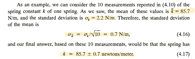

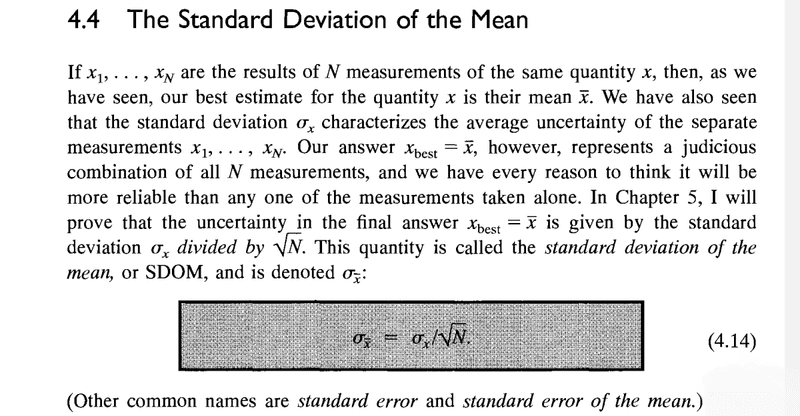

Now I am done with my doubts and I am posting what I learnt through your posts and a book half of which I recently completed : Taylor : An introduction to error analysis.
FactChecker said:
Yes, in the simplest context, the population mean is a true, single number, not a random variable. So the mean has no standard deviation. But that is not the same as the population standard deviation. The population is the entire collection of all possible results of a random variable and it does have a standard deviation.
That's a concept I was lagging with. I didn't know difference between Standard deviation of the mean (also know as standard error = SD/(N)½) and Standard deviation. Both are deviation but in different sense. Former describes that how close our mean is with respect to conventional true value (population mean) and the later one is based on dispersion of measurements.
Taylor in his book (In chapter 4 and 5) described that Uncertainity reported in measurement must be standard deviation in mean not standard deviation (SD).
________________________________________________________________________________________
Further he reported measurement as Mean ± Standard deviation in mean in a example.
Now according to formula which is inversely proportional to number of measurements, we would have a negligible standard error associated with mean if we take a large number of measurements ( Uncertainity ≈ 0 ) But that doesn't mean that standard deviation would be negligible!
And as described above ( Uncertainity as SD/(N)½ ) GUM description for uncertainty (Uncertainity is simply an estimate of the likelihood of nearness to the best value that is consistent with presently available knowledge ) would be the best definition for Uncertainity (valid for small or large number of measurements) as sometimes we are not aware with some of bias components of error and in that condition range in mean as Uncertainity, definitely would not show true value but will describe the best estimate that can be taken in those conditions.
