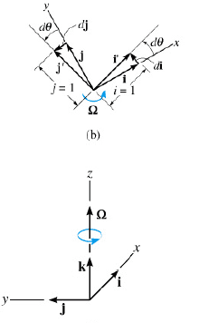

I have just looked up at R.C Hibbeler's Engineering Mechanics -Dynamics book(not the book when I started the topic). Writer uses a geometric approach. In the book i and j unit vectors are drawn orthogonal to each other then turning these i and j vectors by dΘ , new vectors i' and j' are constructed.In the limit when Δt goes dt di is tangent to the path defined by tip of i thus in the direction of j. And dj is in the direction of -i. this is what is written in that dynamic book. I think this is a geometric approach and writer doesn't explain why di is tangent to the path defined
by tip of i while i is rotated by dΘ. But, I think, writing a unit vector, say vector m, as trigonometric components in i and j directions and then taking derivative is a better approach.

Do you have a specific question?
