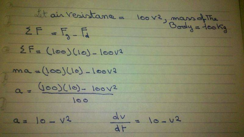

A body with a 100 Kg of mass is falling , what's the distance and time to reach terminal velocity?
a=dv/dt v=ds/dt drag force= 100v^2
F=ma
I don't really need the numbers , just the expressions

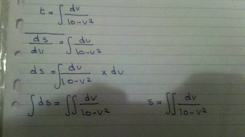

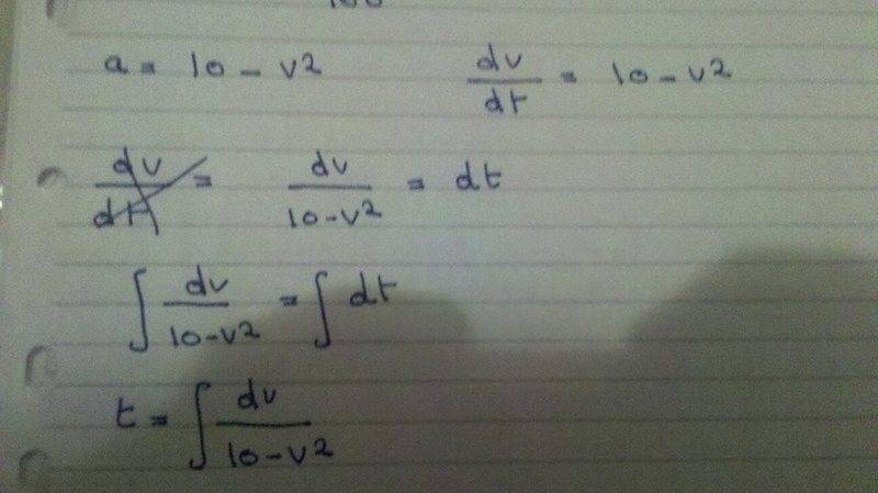

I don't know how to write the equations so I am going to capture my attempt and post as photos. I don't know if I am right or wrong yet. The photos were mixed during the upload , the last photo is the first one and vice versa

Thanks , i did a spreadsheet and i got the answers , my question is : is this calculus approach wrong?
For the time, yes, though my preference would be to keep all the variables as symbols (m for mass, D for drag coefficient etc.) rather then inserting numerical values som early.
You can solve the time integral using partial fractions.
For the distance, the easiest way is to use dv/dt = (dv/ds)(ds/dt) = v dv/ds. That gives you a very easy integral.

So integration does work ? thanks for that ultra-easy integral :thumbs: , the one i figured out was a nightmare
