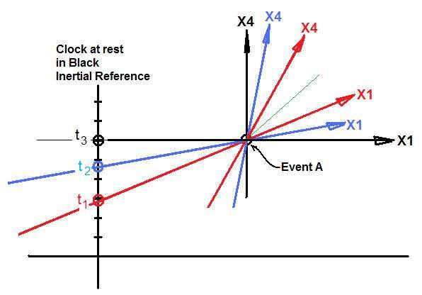

Kingfire, there are at least two different competing interpretations of special relativity on this forum.
1) First, there is what is known as the Lorentz Ether Theory (LET). If you are basing the answer to your question on this interpretation, the answer to your question would be, yes. Yes, your watch physically beats slower. That's because, according to LET, there are time shifts in the transmittal of electrical forces between and within physical objects, resulting in actual changes in speeds of physical interactions, including clock mechanisms (affecting tick rates, etc.).
2) The other interpretation of special relativity is based on the Minkowski 4-dimensional spacetime representation. In this view there is no intrinsic change in clock tick rates. However, different observers (moving relative to each other) live in different 3-D cross-sections of a 4-dimensional universe. We will refer to these as different hyperplanes of simultaneity. If clocks are modeled as 4-D objects, then different hyperplanes of simultaneity will cut across a 4-D clock at different points along the 4-D worldline of that clock (different time points). Thus, different observers will in general read different values on that clock.
These brief comments do not really give you the story, but if you are interested there are those here who could explain this with more clarity and detail.
The hyperplanes for a blue and red observer correspond to the blue X1 axis and the red x1 axis. Three observers pass each other at event A, and each has a different reading for a clock that is at rest in the black inertial reference frame. Each observer is moving along his own X4 axis at the speed of light.
I don't think Einstein ever intended his Special Relativity theory to apply to the real world. He was proposing an idealised world where things did not obey the laws of nature. He postulated a. A world where matter moves in perpetual motion and b. a world where the speed of light is a constant. From those (and other) imaginary scenarios he worked out a system. Sort of like the computer world 'Second Life'.
We all know that is not the real situation. Clocks keep the same time everywhere and no one moves in perpetual motion.

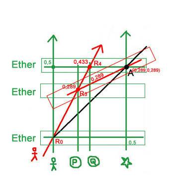

@Kingfire
To link the above to the opening post:
Below I quickly sketched a Loedel diagram for the same LT coordinates. You see that neither the red nor the green worldline is stretched (and definitely not contracted either): In 4D spacetime the spacing of the time units are equal on all worldlines. Proper time is never dilated.
Time dilation occurs because of the different directions of 3D worlds of simultaneous events in 4D block spacetime.
The time indications on the clocks are events that have fixed locations in 4D block universe, but because of the different directions of worldlines in 4D space, the traveler events of the respective worldlines will have other (pre-existing) 'clock with time indication' event in their respective 3D worlds.
(Note: the 3D worlds with their -obviously space-like) clock events are already 'out there' in 4D block spacetime before the 'observer' literally sees the clock events. (A 'lichtcone' scenario only tells you which events have a possible causal relationship with your 'now' event'. But that's not important in this topic)
