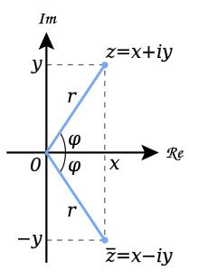

To point you in the right direction, a complex number has two components: an imaginary component and a real component.
The figure below shows two complex numbers on the complex plane.
[Image taken from Wikipedia]
In the image, both numbers are different, although they share the same magnitude. (The figure shows what are called "complex conjugate" numbers, but that's more detail than I wish to get into here.)
My point is that although a complex number can be represented by its real and imaginary components, it can also be specified in terms of its magnitude (r in the figure) and phase angle ([itex] \varphi [/itex] in the figure). [Edit: to be really accurate, that bottom complex number should have had its angle specified as [itex] - \varphi [/itex], but again, that's more detail than I want to get into here.]
For the problem in this thread, the phase angle [itex] \varphi [/itex] isn't very important, but the magnitude is.
Edit: Actually, this is probably a better, less cluttered figure also taken from Wikipedia. So what is the magnitude or "length" (if you will) of that number?:
Yet another edit: In my earlier description, I used "[itex] j [/itex]" to represent the unit imaginary number instead of "[itex] i [/itex]". This is common when discussing electricity to avoid confusion with the current, which is also denoted by the letter "[itex] i [/itex]". When discussing pure mathematics, the unit imaginary number is usually "[itex] i [/itex]", but in electrical engineering (and physics discussing electricity) it's "[itex] j [/itex]".
