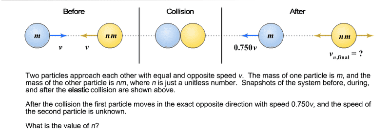

first, i defined my variables. v1i=-v2i, v1f=-0.750v1i, v1f=0.750v2i

I'm just an old high school teacher - used to keeping the notation simple. It might be worth a try that way. Rather than V2f, I used "W" for the final velocity of the nm.
For conservation of momentum I wrote mv - nmv = -.75mv + nmW (1)
For conservation of energy (cancelling all the 1/2's right off):
mv² + nmv² = m(.75v)² + nmW² (2)
It doesn't looks so bad that way, does it? Cancel all the m's to make it even better. I solved (1) for W and substituted into (2) to get an equation in one unknown.
