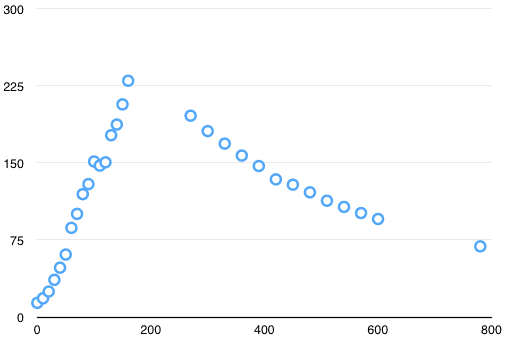

And since you don't appear to have any temperature measuring devices, I went ahead and did another experiment, which involved measuring the temperature of my aluminum pot, with no water.
I'm not quite sure if I'll have time to figure out what the data means, before I have to leave for a Christmas cruise with my friends at the river, but the graph looks very interesting.
x axis = time in seconds
y axis = temperature in °C
Notes:
100°C was reached at time ≈ 70 seconds on the upswing, and ≈ 570 seconds on the downswing.
Somewhere very close to time = 200 seconds, the burner was turned off.

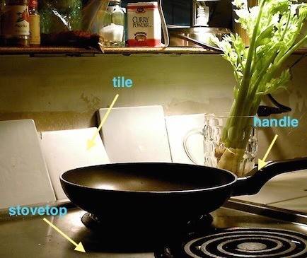

Random temperatures observed at ≈ 700 seconds:
Handle of the pot: 18.6 °C
stovetop: 55°C
tile: 28.6°C
Given the rise in temperature of the tile, my guess is that radiant heat loss, should not be discounted.
