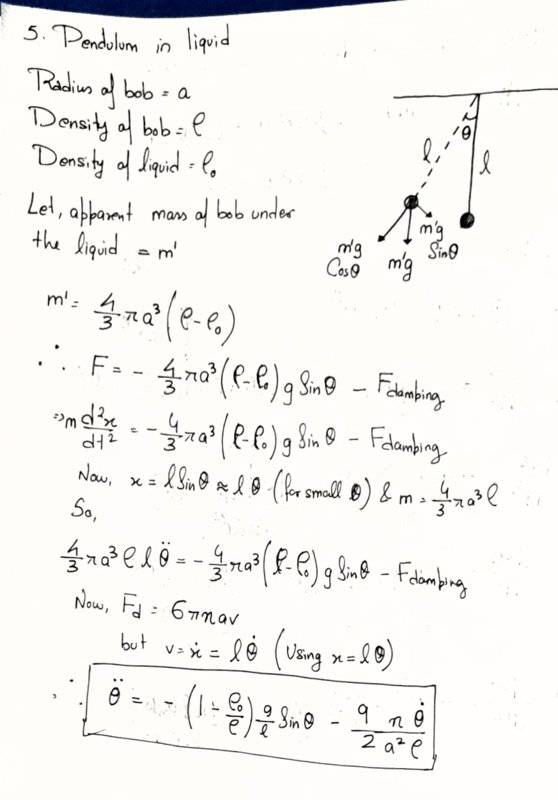

My attempt :-
The confusion that I am having is that to get the required form of the equation of motion, I had to approximate ##\theta## to be small to get ##x=l\theta## so that I could get the acceleration and the velocity. But, I had to leave the ##sin(\theta)## in the equation also. Why shouldn't I use ##\theta## instead of ##sin(\theta)## if I have already used that approximation?
when you write ##g sin \theta## you are evaluating the component of the force along the direction of motion (the tangential component in a circular motion). That direction is not the x direction. So When you write ##\frac {d^2 x} {dt^2}## for the force it's wrong, you should have ##\frac {d^2 s} {dt^2}##, where ##ds## is the displacement in the direction of the motion. It's easy to see that ##ds = l d \theta## and from that follow the equation for the tangential velocity and acceleration. You are not making any small angle approximation here, that comes later when you have to deal with ##sin \theta##
Likes Saptarshi Sarkar
Thanks !
