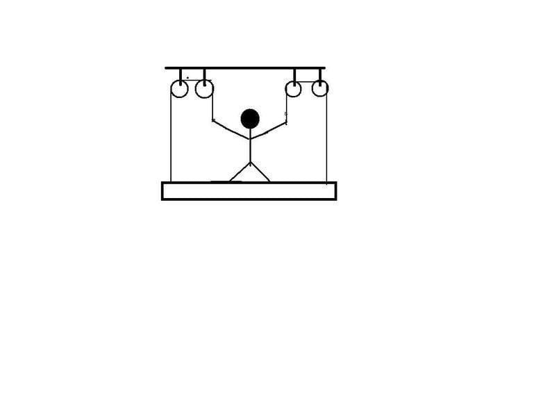

A man of mass m stands on a platform of equal mass m and pulls himself by two ropes passing over pulleys.If he pulls each rope with a force to half its weight,his upward acceleration would be
a)g/2
b)g/4
c)g
d)0
force exerted by man=1/2mg*2=mg
total force exerted downwards=mg+mg=2mg(weight of man and platform)
then 2mg-mg=2ma=>a=g/2
But answer given is 0.How?

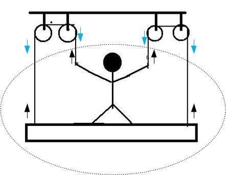

Consider the man + platform as a single system. How many upward forces act on that system?

No. Draw an imaginary box around the 'man + platform'. How many rope segments attach to (and thus pull up on) that system?

I would say four. A segment would be something that exercises a force. A piece of rope slung around a pulley attached to a ceiling can exercise two upward forces, so it's convenient to speak of two segments.
@Bvu,he exercise mg force.
@Bvu,then each rope has two segments,right?
Now the fun thing about a segment of rope in physics is that a) it's weightless ;-) and b) tension forces at each end are equal. That way a piece of rope can be treated as one, but I just talked myself into looking at them as two segments. Doc will decide what's wisdom here. We don't let this hold us back.
So we have four segments pulling up, each with mg/2 (m = man's mass). Right ?
Now we have to complete the man+platform picture. What other forces play a role ?

My reasoning would be 4. So yes, here you could claim that there are 8 segments and we only see 6 chunks of rope. Talked myself in a corner there...
In the picture the two pulleys on the left do exactly the same as one pulley would do. Same for the two on the right. Drawing two each is somewhat sadistic on the part of the composer of the exercise.
My argument for the sections is that a section can exercise a force in a direction. Two sections of a chunk of rope slung around a pulley exercise two forces of equal magnitude but different directions. (Viz. the pulley at the top of the 30 degree ramp earlier).
Here e.g. the leftmost pulley pulls up on the platform and pulls to the left on the second pulley.
The second pulley pulls to the right on the first and pulls up on the man.
This way I bluf my way into considering the piece of rope between the two pulleys as two sections. Others might beg to disagree.

Ah, you fell for the trick question. Half his weight on each of the ropes leaves nothing for the platform !
So here's the drawing doc hoped you would make. The imaginary box is the dotted ellipse ;-).
And you see straight away why I adopted that working definition of a segment. I start liking it more and more!
Now back to business and an answer to the question you deftly circumnavigated: what other forces play a role on the system in the dotted ellipse ?

So? Each end of the rope attaches to the 'man + platform'. Since 4 ends exert their tension on the system, the total upward force is 4 x mg/2 = 2mg.
And why in this case we are considering that the system is at rest?
The system is not necessarily at rest. By applying Newton's 2nd law, you can calculate that the acceleration is zero.
