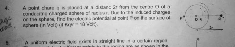

Find the potential at the centre and at P of a hollow uncharged conducting spherical shell if a charge q is placed at a distance of 2r from centre of shell.
(r is the radius)

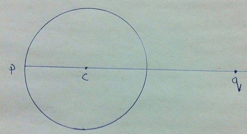

Using method of images, mirror charge is -q/2 and its distance from C is r/2
Potential at centre is then $$\frac{-k\frac{q}{2}}{2.(r/2)}+\frac{kq}{2r}=0$$
Answer given is ##\frac{kq}{r}##
Similarly at Point P, I got ##0## as the potential. But answer given is ##\frac{-kq}{6r}## at P.

P is a point on the surface of the sphere.
Actually, the problem specifies "charged conducting spherical shell". But charge of the shell is not given. So I thought it was a printing mistake. Is there any difference?

The solution to this problem can be done with superposition together with the method of images.
The image charge together with the charge, q, produce an equipotential surface with potential of zero co-incident with the surface of the sphere.
However, that's the solution if the sphere has a charge of -qr/(2r) = -q/2 .
Superimpose upon this, the solution for an isolated conducting sphere with the opposite charge (+q/2). That is, replace the sphere with a charge of q/2 at the sphere's center.
I.e., combine the image charge and this charge at the center.

I'm not sure of the interpretation of the problem.You might be right that the problem meant to state that the sphere is uncharged rather than charged.
Also, it could be that the problem wants you to find the contribution to the potential at P due to just the induced charges on the sphere. When I work the problem with this interpretation, I get kq/(6r) which differs in sign from the given answer. So, I'm not sure what's going on.

For there to be an equipotential surface at the location of the surface of the sphere, you replace the sphere with the image charge ( -q/2 ). That as it turns out gives a potential of zero for the sphere. However, Mr. Gauss tells us that this solution is equivalent to the sphere having a net charge of -q/2 .
So we need another charge. One with charge of +q/2. Where can we place it?

The example in that link has a grounded sphere. The problem in this thread has a neutral sphere. That grounded sphere does have a non-zero net charge.

The image charges along with the external charge give you the potential everywhere external to the sphere, and on its surface. The potential inside the sphere is constant and is equal to the potential at the surface. Do not use the image charges to calculate the potential inside the sphere.
