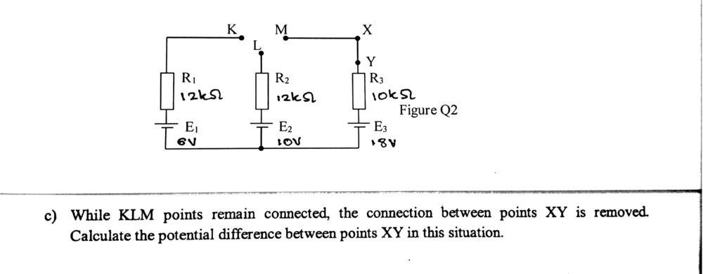

While KLM points remain connected, the connection between points XY is removed. Calculate the potential difference between points XY in this situation.
V=IR, KVL
Problem Statement: While KLM points remain connected, the connection between points XY is removed. Calculate the potential difference between points XY in this situation.
Relevant Equations: V=IR, KVL
And you will now show us your work...

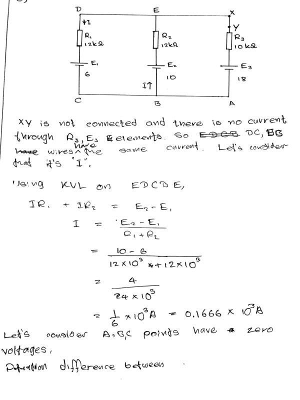

Here is how I tried. I don't know how to solve further. I don't know how to calculate the potential difference between those points.
I'm sorry for not understanding how things work here.
I don't know how to find the potential difference between those points. So I can't slove further.
Since you defined ABC as 0 potential, what is the potential at point Y? Recall that you said there is no current through R3.
Using similar reasoning can you find the potential at point X? What do you need to know to calculate the potential at point X?
Note: your current calculation is off by 1,000,000 times. Except for the sign error it's correct.
