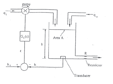

Hi all, got a Control question here, and I'm struggling with what I assume is a simple algebraic step. Thanks in advance!
A closed loop control system governs the level of water in a tank (H(s)) to meet a target height (Hi(S)). The flow of water into the tank is controlled by a transducer that feeds the current level of the tank into a differencing junction that works out the error (H(s)-Hi(s)). The flow rate of water pumped in is proportional to this error, with gain K.
The flow out of the tank is also constrained by a linearized flow restrictor, with flow out equal to the height/constant (Qd=H(s)/R).
There is also an additional flow into the tank from a separate pipe, with flow rate Qd.
The question is to find the transfer function, time constant and steady state gain. I've attached a diagram.
So far I've gotten as far as the governing equation:
Qi + Qd - Qo = A.dH(t)/Dt
Laplace: Qi(s) + Qd(s) - Qo(s) = A.s.H(s)
Where Qi = Flow in
Qd = Additional disturbance flow
Qo = Flow out
A = XSection area of tank
Using the information about the individual components this goes to:
K.Hi(s) - K.H(s) + Qd(s) - H(s)/R = A.s.H(s)
The correct way to describe transfer function (Checked with answer booklet):
H(s)=(R.K.Hi + R.Qd(s)) / (R.k +R.A.s + 1)
But I can't get the hang of expressing it in a way that would allow me to get the specific time function, ie I can't arrange it into form H(s)/Hi(s)=u/(1+Ts) where u is the SS Gain and T is the time constant.
Any help with this step would be fab!
Regards
You have the right equation, so why can't you form H/Hi?
Is you problem the fact that you have a transform of the form a/(bs + c + 1)? Surely you know how to change that to the form d/(es+1)? High school algebra! :-)

Righto! Let's take the general expression a/(bs+c+1). Now, divide numerator and denominator by c+1. What do you get?

How about a/(bs + c+1) = d/(es+1) where
d = a/(c+1)
e = b/(c+1)
Yeah, I can't do it. Have been trying for a bit now, wasting far too much time on something this simple!
Have gotten something like:
(R^2(K^2.Hi + K.Qd(s)) - R(K.Hi + Qd(s))) / (R^2(A.K.s + K^2) - R.A.s -1
Move all the H(s) terms to the left-hand side of this equation (which you yourself correctly derived). Then form H(s)/Hi(s). You must realize that there are really two transfer functions: H(s)/Hi(s) and H(s)/Qd(s). The problem ask you for the former only, so disregard the latter.
Then reduce the denominator of H(s)/Hi(s) to es+1 as I've shown you.
Don't give up!
