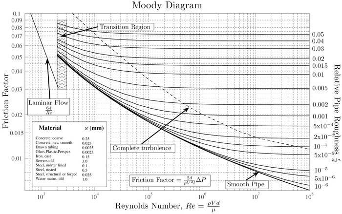

in my book , the author stated that the friction factor become maximum when the flow become turbulent ...However , according to the Moody Chart , we can know that the friction factor decreases from laminar to turbulent and then constant ... is the statement in the book wrong ?

It would appear to be so, based on the Moody diagram.

I think the author should have said that the friction factor reaches a minimum when the flow becomes fully turbulent.

While I agree that the total friction varies as flow velocity squared, the author doesn't say that the total friction is a maximum for fully turbulent flow; instead he says the friction factor is a maximum. That distinction is the one thing which operates in the author's favor.
The Moody diagram, which plots friction factor versus Reynold's No., and by extension flow velocity, shows that the friction factor assumes a constant value which is independent of the Reynold's No. of the flow and hence the flow velocity for fully turbulent flow. That's what all those horizontal lines indicate on this diagram:
For a given value of relative pipe roughness, the friction factor takes on a relative maximum value somewhere in the transition zone between fully laminar and fully turbulent flow. Granted, the Reynold's No. at which the different types of flow appear seems to be somewhat arbitrary, having a minimum friction factor in the turbulent zone is quite obvious from the Moody diagram.

No.
foo9008 said:
, the author 's statement that the friction factor will become maximum is wrong
Yes.
foo9008 said:
so , it is true that the friction factor will increase when the flow become fully turbulent ?
No. Read my Post #8 above and look at the Moody diagram.
so , the author 's statement that the friction factor will become maximum is wrong ?
Yes, obviously.

No, it operates against the author. The total friction increases as the velocity increases, but the friction factor decreases.

so , correct statement should be , the total friction become maximum ,while the frictional factor become minimum ?
foo9008 said:
soso , correct statement should be , the total friction become maximum ,while the frictional factor become minimum ?
Yes.

No. The friction force is a product of various terms. One of them is the friction factor. As the flow velocity increases, the friction factor reduces a bit, but the other factors increase more, so the friction force overall increases.
