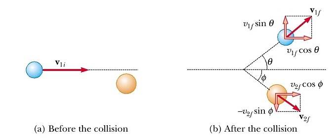

So this is just something i came up with to check if i am understanding everything allright, it all comes down to collisions in regard to the center of mass
So two "masses" experience a glancing collision
M1:
vi - 3m/s (refered to as v1i) ;
m - 2Kg (m1)
M2
vi - 0 (v2i) ;
m - 6Kg (m2)
what i did was figure out the speed of the center of mass (Vcm) using:
Eq(1) (v1i*m1 +v2i*m2)/(m1+m2)
and then since the Vcm is constant before and after the collision (right?) i figured out v1f and v2f because:
eq(2) v2f=2vcm-v2i (and same for v1f)
this is were i get stuck, using the system:
Sys(1)
-v1f*m1*sin(theta) + v2f*m2*sin(theta2)=0
m1*v1i=v1f*m1*cosin(theta) + v2f*m2*cosin(theta2)
so using eq 1 and 2 i get Vcm=3/4 and v1f=-3/2 and v2f=3/2
and i can't solve the system, all the other glancing colision problems i have seen give one of the angles.
plus the masses are different so the angle bettwen theta and theta2 isn't 90º, i don't know what to do.
This is true in one dimension only, where "glancing collision" does not make sense. The magnitude of the velocity stays the same, but the direction can change.

WrongMan said:
Ohh i see, thanks, so there is no way to solve 2-d exercices using the centre of mass?
so, new questions:
1. there is no way of solving a problem like this using only the information provided, correct?
2. provided 1 is correct, imagine say v1f is a given value by the exercice, i should figure out v2f using conservation of kinectic energy, what should i do next? i still don't think i have enough information to solve the system...
i've set v1f to be 3/2, so v2f is +/- sqrt(2), how do i figure out the angles? i don't know any of the components of the two velocity vectors, only the magnitude...
Im failing to see how to relate the angles of the system.
The book clearly states as long as no more than 2 of the (seven) quantities of the equations in the system are unknown it is solvable, so there is a way of solving the system i just can't figure out how
You can use centre of mass, but whatever method you use you need to know the angle of impact. That is, the line that the initial relative velocity makes to the normal where the surfaces contact. (This is ignoring friction.). If that normal does not pass through the mass centres then it gets nastier, since torques will be involved and the objects will acquire spin. So assume the objects are spheres.

thanks @haruspex, alllow me to clarify, this is a simple case (i think)
this is the sort of collision I am talking about:
So, imagine i know, v1i (v2i is 0) and i know the masses (which are different), and I am also given v1f
with this info, knowing its elastic, i can use the conservation of kinectic energy equation to figure out v2f.
all that is left to find out is theta and phi,
with:
m1*v1f*cos(theta)+m2*v2f*cos(phi)=m1*v1i
and
-m1*v1f*sin(theta)+m2*v2f*sin(phi)=0
because there are 2 unknowns and 2 equations. I am supposed to find out theta and phi but i don't know how (algebra failure?)
with:
and
What is the relationship between the sin of an angle and its cosine?

No, a relationship involving only the sine and the cosine and constants.

Pythagoras!

the basic? sin(x)= opp/hyp ? Ok I am doing this and i think its working.
i get something like
m1*v1fx+m2*v2fx=m1*v1i
-m1*v1fy+m2*v2fy=0
and then i write v1fy in respect to v2fy (and v1fx to v2fx), and use the pythagoras hypotnuse formula of the both triangles as a system and solve (since i know the hypotenuses, and i wrote v1x and v1y "as" b*v2x and a*v2y)
Am i correct?
everything seemed to work out.
One last question, i got both positive angles, and both positive values for Vy, i imagine this is because it doesn't matter which particle goes up or down, i just have to pick which one i set..
but the angles are both positive also? that confused me a bit, is it also because "i get to choose" which particle goes up and which goes down?
the angles i might have messed up/confused somehow with the signs in the equations, but I am pretty sure i didnt mess up with the V signs
The way you defined the signs, everything should be positive.

I meant sin2+cos2=1, which is equivalent to the Pythagorean formula. Looks like you got there anyway.
