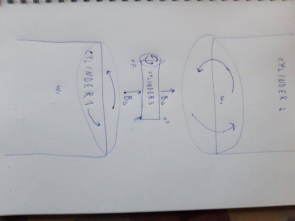

I was thinking about an experiment to demonstrate gravitomagnetic effect. I did my calculations using gravitomagnetic model. It is not as accurate as general relativity, but GR should give similar predictions. I do not know if it would be possible to to this experiment in real life(are there enougth accurate sensors and tought materials).
installations consists of three spinning cylinders. first to cylinders are for creating a magnetic field. last one is for detecting gravitomagnetic field. last cylinder under axis 90 degrees angle compared to first two cylinders.
gravitimagnetic field created by first two cylinders right between the cylinders: ##B_G=\frac{\mu_G \omega_1 \rho_1 (r_2^2-r_1^2)}{2}##
  • ##\omega_1## is angular speed of 1. and 2. cylinder.
  • ##\mu_G##is gravitomagnetic constant ##\mu_G=\frac{2 2\pi G}{c^2} \approx 9.33\ 10^{-27} N/kg^2 s^2=9.33\ 10^{-27} s/kg##
  • ##\rho_1## is density of 1. and 2. cylinder.
  • ##r_2## is 1. and 2. cylinders outer radius.
  • ##r_1## is 1. and 2. cylinders inner radius.
torque on third cylinder because of gravitomagnetic effect is crosswise to its angular speed and angular speed of first two cylinders.
##\tau=\frac{2\pi \rho_3 (R_2^4-R_1^4) \omega_3 B_G}{2}=\frac{\mu_G \omega_3 \rho_3 (r_2^2-r_1^2) 2\pi \rho_1 (R_2^4-R_1^4) \omega_1}{4}##
  • ##R_1## is 3. cylinders inner radius.
  • ##R_2## is 3. cylinders outer radius.
  • ##\rho_3## is density of 3. cylinder.
  • ##\omega_3## is angular speed of 3. cylinder.
What you think what is the highest value for ##B_G## and ##\tau## we could practically get?

On top of everything else, I am not sure that conceptually this is correct. Which way does the third cylinder want to rotate? And why?
(If you say "because of the right-hand rule" as part of your answer, my next question is "and where does that come out of GR?")
because of the right-hand rule. I use Gravitoelectromagnetic model, which is approximation for GR where gravitational fields are small.

Depends on the sense of rotation of cylinders 1/2 and 3, I think. You could look at pairs of ingoing and outgoing geodesics near the pole of a Kerr black hole, I guess?
I'm also slightly concerned that this is applying a non-coaxial torque to a spinning cylinder - i.e. a gyroscope. In other words you'd need to look for precession, which is likely to look very like vibration from the spinning...
I'd like to know where it comes from.

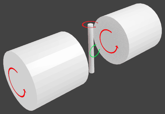

I'm a bit unclear why you need or want three cylinders. Your diagram isn't really clear to me, reverse engineering of what I think you should be doing suggests two cylinders should be enough.
[add] Ibix's 3d diagram seems clear, if that's what you're suggesting, I don't see the need for three cylinders.
One cylinder is needed to generate the gravitomagnetic field, the second is redundant. A second is needed to measure the torque. But your diagram isn't clear enough that I'm confident that you're doing what I think you should be doing.

Let's assume Cylinder 3 rotates clockwise in the green direction.
If I reverse the spin of the big cylinders, the rotation becomes CCW. Now reverse the spin of the small cylinder, and it's CW again. It looks to me like a parity-odd transformation, which is a peculiar outcome from a parity-conserving theory.
I would like to getestimation on maximum ##\tau## and ##B_G##. For that I need maximum ##\omega_1\ \ \rho_1\ (r_2^2-r_1^2)## and maximum ##\omega_3\ \rho_1\ (R_2^4-R_1^4)##.
Do you think ##\omega=\sqrt{\frac{2\ K\ \sigma}{\rho}}## is correct?
if it is then
##|\tau|=\frac{2\pi \rho_3 (R_2^4-R_1^4) \omega_3 B_G}{2}=\frac{\mu_G \omega_3 \rho_3 (r_2^2-r_1^2) 2\pi \rho_1 (R_2^4-R_1^4) \omega_1}{4}=\frac{2\ K\ \sigma\ \mu_G\ (r_2^2-r_1^2) 2\pi\ (R_2^4-R_1^4)}{4}##
