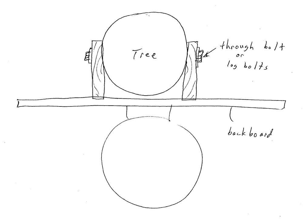

Here's a sketch of how I would do it.
Two vertical boards, one on each side of the tree. Fasten with either through bolts (threaded rod) or lag bolts. The bolts should not be tight because the tree is growing, so you might need to go up every few months and loosen the bolts a little.
Absolutely do NOT use nails. Things move, then the nails break. I learned this when I built a tree house as a kid.
I like the plan. If I understood the OP sketch of the backboard, though, there were two vertical stiffeners on the back of the backboard which are probably what you want to tie to. Hence an intermediary set of horizontal boards in my recommendation.

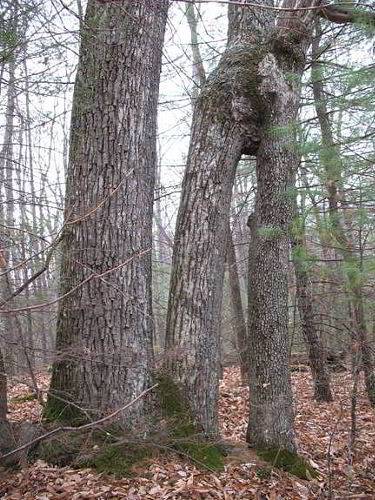

Plant Anatomy says you are likely wrong.
Consider reading Eames & McDaniels 'An Introduction to Plant Anatomy'. One of my texts in grad school. Palms are not dicotolyedons, they are more related to grasses. No growth rings, no ring of vascular cambium like dicot trees. The simple non-technical answer is the tree would simply swallow the hoop. Like all Biology it has to have a name. It is called anastomosis, in the botanical version of the meaning of the word. Ever see two tree trunks or branches from separate trees? Sort of fused together to the point where they form a blob-like inseparable connection? They can even share sap. Roots and forest fungi hyphae do this on a vast scale in forests.
But you are correct, it will not work for the OP, for other reasons.
Picture of the fusion for two dicot trees.

Courtesy of Native tree society
Likes berkeman and hutchphd

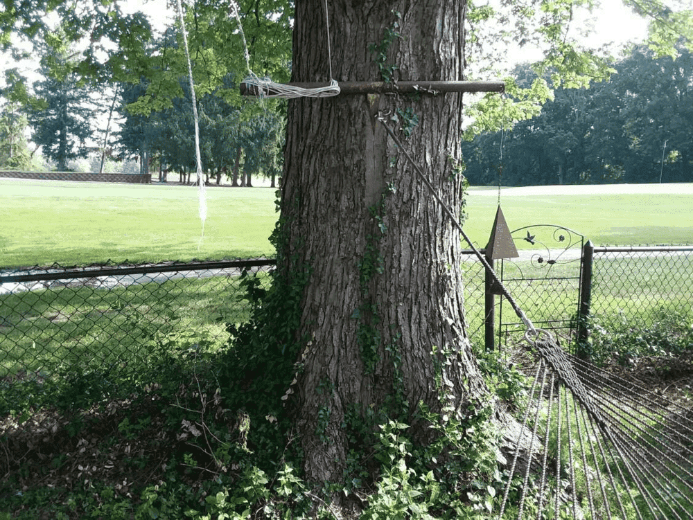

A long time ago someone put up a clothesline "T" made of welded 2 inch galvanized next to the little maple tree out back. Now it is later and it holds my hammock (with a little help from the maple).

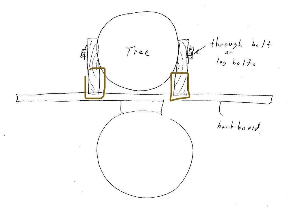

The problem with those 2 boards (stiffeners) on the back is that I believe they don't extend out long enough:
Ill try it today and see.

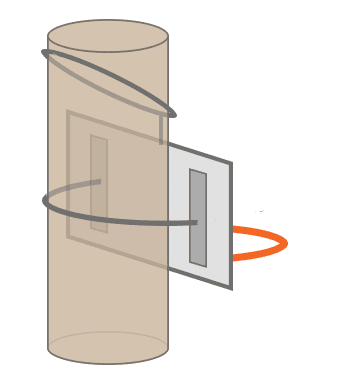

I agree about the rope [sorry, i hadnt seen the rest of that post cause i read it on my mobile]...aamof i like that idea way better. And I just found about ~20ft of 3/4" rope.
Ok so should I drill holes on those stiffeners and tie it around the tree trunk? I would still need to add something to keep it from sliding down the trunk.
You probably won't need anything, but I suggest simply a loop around the tree a foot or two above the backboard should provide enough tension and hold by friction.
