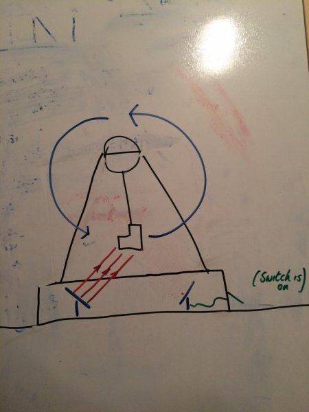

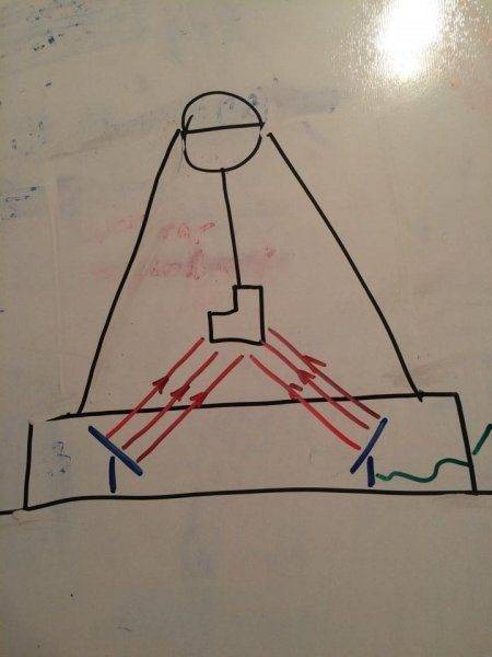

I had an idea whilst waiting for your reply, theoretically I don't see why it couldn't work.
I put the images in spoilers to keep the post tidy.
The above image is the device in its 'off' state, really oversimplified drawing I know, but bare with me. Say we have a magnet mounted in the cart that's attached to the end of the arm, the blue things in the base are the magnets and the red lines represent the imaginary attraction/repulsion between the magnets. So as you can see with both magnets trying to repel the cart it will keep it steady, in a state of equilibrium, however if we flip the switch and allow current to flow into the magnet on the right reversing it's polarity there is no longer a second force present keeping the system in equilibrium and thus it should move off in the direction show in the second image below.
I know that reversing the polarity of said magnet with a current will cause the cart to be attracted to that magnet then instead and this could possibly pose problems, what do you think?
As far as skill level goes its pretty low in relation to circuitry, I have a decent workshop available to me at school and I also study Physics so I know a fair deal about Magnetism and motion etc

I'd been thinking of a permanent magnet (or two) that gets rotated or flipped .

Your electromagnets might work also

I'm concerned a magnet system would be much harder to adjust the acceleration IE 20G's at the start will be obvious even if it settles to a stable rotation
