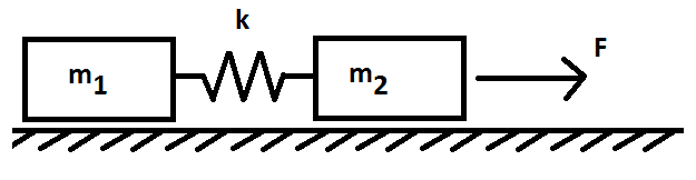

Hello all,
Semester has just started and i am dong a 4th year dynamics unit, so i am reviewing the previous years unit which was a pre-requisite for the unit i am currently doing. I have come across a rather difficult dynamics problem that was given as a challenge question at the beginning of last years course - one which i never managed to solve. It is really doing my head in and I am hoping someone here can help me with it?
It is as follows:
Two masses connected by a linear spring, constant k. A force is applied to mass m2.
There IS friction.
What is the minimum constant force F that will cause mass m1 to move?
I am assuming that the spring can be considered massless, as i have never been given a problem in which this was not the case, and a spring mass was not given.
And I forgot to indicate in the image that gravity acts downwards (perpendiculat to the surface), not that it matters.
I tried many solutions, all of which I was told were wrong. Below is one of them, I will type more of them up later when i have some spare time if necessary.
Thanks in advance
Chris
that is good.
Some things to consider.
1) Why do you say the "force across the spring must be zero" What is in equilibrium to justify this?
2) You have not offered a coefficient of friction. Is it the same for m1 & m2
3) have you considered what happens if
m2 > m1
m2< m1
m2 = m1
Your solution is OK if you increase the force F very slowly from zero, so you can ignore the inertia of the masses. (Obviosuly m2 has to move to stretch the spring, before the spring applies enough force to move m1).
But if you suddenly apply a constant force F, m2 will accelerate and then slow down as the spring stretches. You will be able to move m1 with a smaller force than your solution.
You could find F by by solving the equations of motion, but an easier way is to think about how much work you need to do to the system to get it to the state where m1 just starts to move.

Consider this:
Mass, m1 will begin to move when the spring is stretched just enough so that the spring force overcomes the static friction on m1.
HeZ said:
So if i were to solve it from a work point of view, I would need to determine when enough energy has been put into the system (stored in the spring + dissipated due to friction on m2) for the force on the spring connected at m1 to be greater than the friction force of m1 (force at spring-m1 connection: Ff1 = kx + F).
Does that look like a good starting point for this method?
Yup, that's the right idea.
For the minimun value of F, the mass m2 will have zero velocity at the instant when m1 starts to move, so the system has no kinetic energy at that moment in time.

Thank you both Studiot and AlephZero for your replies. Two very different approaches to the problem. I plan on attempting them both as I believe it is important to have multiple ways of solving a problem available to me.
@Studiot:
Still a little confused about your method.
The spring extends until it offers a restoring force equal to F2, given by the spring equation. At this point the system is restored to equilibrium and halts.
Do we not need to consider the momentum of the mass m2 at this point?
@AlephZero
I think I have a solution here.
A step force is applied. Assuming that this force is sufficient to break static friction of m2 (F > Fm2-static) then m2 begins moving.
Block continues to move until the spring stops it. If we are considering the minimum force applied to move m1, then spring deflection at this point will be x1.
Where: Fm1-static = kx1
ENERGY in system whilst m2 is sliding:
0.5kx2 + 0.5m2v2 - Fm2-kineticx = Fx
ENERGY in system at instant when m2 comes to a rest:
0.5kx12 - Fm2-kineticx1 = Fx1
A little bit of algebra later:
0.5kx1 - Fm2-kinetic = F
Recall that:
kx1 = Fm1-static
Hence:
0.5Fm1-static - Fm2-kinetic = F
Thus in order to move m1 (Assuming already that F > Fm2-static):
F ≥ 0.5Fm1-static - Fm2-kinetic

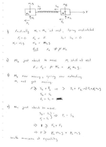

Another tip - it is fundamental to be able to extract or draw good isolation diagrams or free body diagrams to solve mechanics problems. Knowing what to isolate is key to most solutions. Knowing also when a system is even momentarily in equilibrium is also useful as the equations of equilibrium cna be applied at that instant.
I have worked through a chain of reasoning in the attachment, starting from rest and considering situations with successively increased values for F.
I have assumed that the coefficient of friction is the same for both masses for convenience.
Firstly in (1) F is not large enough to move anything so the system remains at rest.
In this situation there is no force at all transmitted through the spring so there is only vertical equillibrium acting on mass1.
Mass2 has horizontal forces acting but note that the friction force is only large enough to oppose F . The mass has not reached limiting friction.
At limiting friction mass2 is just about to move, the remainder of the system is the same as in (1)
Once mass2 starts moving it is no longer in equilibrium.
However at this time F is not strong enough to also move mass1 so mass 1 remains in equilibrium.
However mass1 now has horizontal forces acting which we can write an equilibrium equation for the friction force and the spring force.
(so we are considering mass1 as an isolated or free body)
This gives us a spring force to substitute into the equation of motion for mass2, which is being accelerated by the difference between F and (the mass2 friction plus the spring force).
The minimum possible difference is an infinitesimal amount above zero which is the answer to the question asked.
