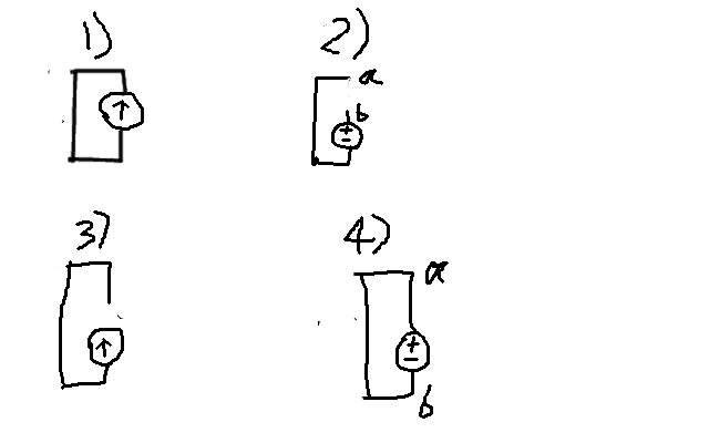

first of all sorry for bad drawing, is all of the following correct :
* number 1 : the current will flow normally
* number 2 : the voltage source will not give current but Vb-Va = V of the voltage source (10 for example)
* number 3 : no current will flow
* number 4 : the voltage source will be considered as a wire Va-Vb=0

Looks correct to me. :smile:
(keep in mind that shorting out a voltage source like in #4 is generally a bad thing...)

I am not sure what statement number 4 means. If the wire is an ideal wire, with zero resistance, that is the end of the voltage source, and if the wire has sufficient resistance not to damage the voltage source, then statement number 4 is wrong.
Couldn't have said it better myself, except to add that in the first condition, the wire is ideal, it still doesn't really make sense to say "the voltage source will be considered as a wire" but rather to say "this is an impossible situation"

yes i am talking about ideal wires
the voltage of the source is just v and we conclude since it is shorted that v is 0 therefore there is no battery primarily and there is just wire, it is like we are testing for the possibility of existence of a battery under this situation, but if we know in advance the existence of a battery with a specific voltage (10 for example), this voltage rise will not meet the required voltage drop to make the net voltage 0 so it may explode producing an open circuit not a wire

An ideal voltage source has zero output resistance, so shorting it results in infinite current. A real voltage source has a finite output resistance, so shorting it results in a large (and potentially destructive) current. Please do not ever do this in real life.

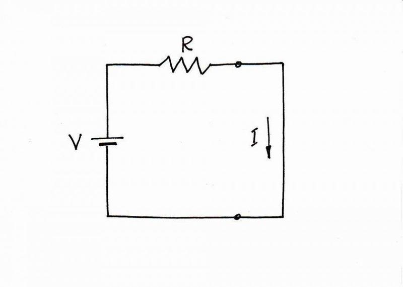

Mohamed el teir,
i was looking at your circuits and i do not understand the logic of the four drawings-1. you have shortcircuited perhaps the cell/which we do not do or forbid people in the lab- it may lead to burns/accidents.
if one wants to draw a circuit he puts up a load- a bulb and puts in an ammeter and a voltmeter as by looking at the source and wires you can not say which way the current is moving and what is the state of voltage source. so if you have a multimeter you can say definately about the current etc - so my request will be to pick up a school science textbook a nd draw electrical circuits by their 'rule' otherwise people will be just guessing what your aim is!

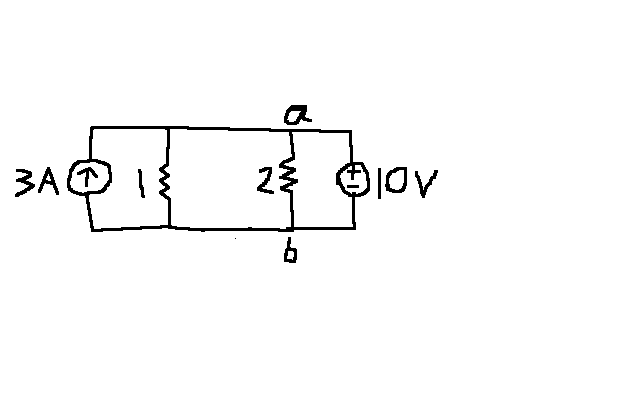

take a look at this:
if you want the equivalent norton circuit at terminals a-b (in the 2 ohm resistor area),to get R norton you will remove the 2 ohm resistor, put SC instead of battery and OC instead of current source so the equivalent R will be 1 ohm connected in parallel with 0 giving 0 resistance, to get i norton you will put SC instead of 2 ohm resistor, here we see that the battery is shorted, will we say i norton is infinite ? and since v thevenin (= 10) divided by R thevenin (= R norton = 0) equals i norton we will get infinite also, is norton inapplicable here ?

@mohamed el teir, an ideal short on an ideal voltage source is impossible because it is an inherent contraction in terms. An ideal short has zero volts across it and an ideal voltage source has a non-zero voltage output. Do you really think you can have both at the same time?

Both 1 and 2 are fine. Both 3 and 4 are impossible for ideal components.

The problem with 3 and 4 is not about whether you want to allow infinity as a valid value. The problem is that both circuit 3 and circuit 4 are not self-consistent.
For circuit 3 the current source says "the current is I" while the open circuit says "the current is 0". The current cannot be both I and 0, so the circuit is not self consistent.
For circuit 4 the voltage source says "the voltage is V" while the short says "the voltage is 0". The voltage cannot be both V and 0, so the circuit is not self consistent.

This is a perfectly acceptable circuit. The current through the 1 ohm resistor is 10 amps, the current through the 2 ohm resistor is 5 amps. That's 15 amps, 3 of which is provided by the current source and 12 of which is provided by the voltage source. The current source has 10 volts across it, which is fine, and the voltage source has 12 amps through it, which is fine.
This floundering around with specific cases really isn't the best way to learn this stuff. Clearly, you need to go back and study the basics of voltage sources and current sources. It's all very simple, it just takes a bit of getting used to.

right, about 1 and 2 : are they consistent because:
1 : the source says current is I and SC doesn't affect it (the current in the rest of wire is also I)
2 : the source says voltage rise = V and open circuit doesn't affect it (the voltage drop on the open circuit is also V)
correct ?

i didn't say it is wrong circuit, i said how to get norton current in the a-b area (across the 2 ohm resistor) ? it will lead to short circuit on the voltage source on the right
(as in norton you replace the R(L) (the 2 ohm here) with SC)
correct ?
Yes.

You are missing the point of the Norton equivalent, which is to draw a circuit with parallel resistance and a serial current source based on removing the external load. There is no problem with that. At A/B, you remove the external load (the voltage source) and you have a simple Norton equivalent of 3 amps with a parallel resistance of 2/3rds of an ohm.
AGAIN, you really would do better to study the basics, I think, than to keep coming at it by examples. Once you have the basics under your belt, the examples become trivial.

we took norton equivalent in the lectures in a different way, i don't invent examples, i am telling you the style of questions they give us and the steps of solution they told us, first of all in the question it tells you what is the external load to work on (2 ohm here) then to solve these are the steps explained to us in the lectures :
1- remove this load and replace batteries by short circuits and current sources by open circuits and get R between a,b (here it will be 0)
2- replace the place of the load with SC and calculate the current in that SC (here the SC will be parallel to the battery and that is what i was asking about)
you took the load as the battery but as i am saying the examiner enforces you to choose a specific load (2 ohm here), they forbid us in the lectures from using voltage sources as external loads in norton just resistances

In that case, the question makes no sense. A Norton equivalent has a current source in series with the load and a resistor in parallel with the load and an undefined load voltage. You can't do that in this circuit if the 2 ohm resistor is the load and the voltage source stays in the circuit.

mohamed el teir said:
we have short circuit saying voltage is zero, but this saying is based on the resistance being zero so multiplying it by current gives zero, but this in case current has a real value, if current is infinite we can't say voltage is zero
"we have short circuit saying..."
like in open circuit, we have zero current in open circuit, but we can't say voltage drop is zero, because resistance is infinite
"like in open circuit..."
  • #34
this in short circuit
this in open circuit
Thus demonstrating the need for proper punctuation.
Likes phinds
  • #35
i have just remembered something, i understand the consistency principle and i am totally convinced that number 3 is wrong because the wire must have the current 0 and I at the same time, but regarding number 4 i think the concept of infinity has a rule, now we have short circuit saying voltage is zero, but this saying is based on the resistance being zero so multiplying it by current gives zero, but this in case current has a real value, if current is infinite we can't say voltage is zero, like in open circuit, we have zero current in open circuit, but we can't say voltage drop is zero, because resistance is infinite, so what do you see ?
Take one step back. Before you even get to the point of figuring out how much current goes through the voltage source you have to set up a system of equations which describes the circuit. This is done before solving. The equation for the wire says that the difference in voltage is 0. The equation for the source says that the same difference in voltage is V. So the equations describing the components are inconsistent, even before you ever go to solve for current.
