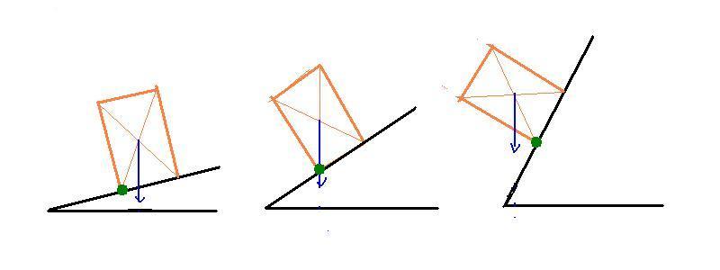

We consider Rectangle Parallelepiped on a board and a=1m ; b=2m and c=3m.
The face a and b is considered touching the board.
there’s no sliding; we tilt the board so a is horizontal.
Q: Starting from which angle we can see a rotation?

Hi Rehzhor, welcome to PF.
The rules of the Forum require that you show your attempt to solve the problem. If you tried so many things, show at least one of them.
Try some experiment, it will give you ideas. A matchbox on a hard cover of a book, for example.
Look at the picture, when does the box turn over the edge shown in green? (The blue arrow represents the force of gravity.)

As for the match box I'll say it's in the second and third picture? I mean the center of the gravity looks only good on the first one. (Thanks for helping me out! I really suck at this.)
It seems they want to know at what angle, when you lift it up, will the structure begin to topple or fall over.
Yes, the second picture is the limiting case. You increase the angle of the board just a little, the box will topple over, like In the third case.
Look at the torque of gravity. In what direction does it "try" to turn the box in the pictures? When can it turn the box ?
What is the torque in the second picture? What is the angle the board makes with the horizontal in that case?

I do not see what you do. Use side view instead of the "3D" picture, as I did in Post #2.
The problem states that there is no sliding, so the net force on the block is zero. You have to consider the torques.
In picture A, you see that the parallel component of mg would rotate the block anti-clockwise, and the torque of the normal component cancels with the normal force N. The force of friction has no torque. If the parallel component of gravity turns the block just a tiny bit away from the slope, the normal force does not act any more: The torque is from gravity alone. In B, gravity would turn the block clockwise around the fulcrum (green ), so it goes back to the initial position, its base touching the slope again. The block is in stable equilibrium.
In case C, gravity would turn the block anti-clockwise around the fulcrum, the block is unstable.
In Case D, the line of attack of gravity goes through the fulcrum. What is its torque? . What happens if you increase a bit the tilt of the the slope?
