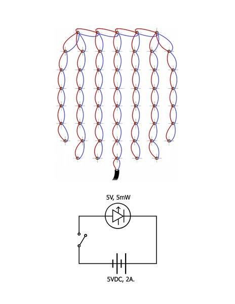

I think I get a reading of 2.7A because of the voltage drop. I assume the diodes burn out (COD) as they stop working. Here is the history:
I wired 52 diodes. 2-3 soon stopped working. I replaced the ones that stopped working then three more died (two were different). I stopped replacing dead diodes and sought help. I powered up the circuit for several hours many times for two weeks now, without any more diodes burning out. I fear replacing the present three dead diodes will cause more diodes to fail. The latter would suggest that inadequate power supply. But maybe I just had some bad diodes. I am a doctor, with only basic knowledge of electronics. I'm not sure if an MOV would help, connected between the positive and negative wires, between the Li-ion battery and the circuit.
Inspecting one of the diodes, I see no resistor therein as I recognize one to be (color banded). No data sheet is available. Attached is my circuit. The diodes fit into a hat, used for stimulating mitochondria in hair follicle roots to promote growth (<< URL Removed by Mentor >>).

As already mentioned, you cannot wire up laser diodes to a DC power supply without some form of current limiting and control. Where did you get them from?
well I'm not surprised they burnt out, you had no current limiting drivers for them
EACH laser diode needs it's own driver
read my previous post :smile:Dave

Djard said:
but if each diode needs a current limiting driver, why are the rest not burning out
If there is a sufficient load to bring the operating voltage withing acceptable limits than you could just be lucky.Your connections (plus the internal construction) are just enough resistance that the diodes don't blow immediately. You are certainly over-driving them.

The purpose of a single resistor is to set the current.
By supplying just a voltage source, the current through the diode will vary quite a bit from diode to diode.
You want to use a current source to directly control the current. A "cheap" current source is a resistor in series with the diode. You know approximately what the voltage drop across the diode will be, so if your voltage supply is 2.9v V, and the voltage drop of the diode is typically 2.8 volts nominal. The voltage drop across the resistor is 0.1 V. So the current through the diode will be 0.1V / the resistor value. Note, as current changes, the voltage drop across the diode will change, so it can be tricky to choose the resistor value, which is one of the reasons why this is a "cheap" method.
If you use multiple diodes hooked up to this cheap current source, then the current through each one will vary, therefore the brightness across all the diodes will vary.
I would recommend at a minimum using the precision current source Jim posted. You follow that equation to set the current based on your desired intensity.
Like davenn said, it is recommended that you use an individual driver for each one, but I am curious as to why.
