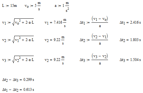

Let us make a concrete model to test this assertion. In our model the train is constructed from materials we store in the same box that we keep our physicists best stuff, like massless pulleys and light flexible strings. In other words, no flexing, stretching, or other shenanigans.
Each car has length L = 15 m. Acceleration is a constant a = 1 m/s2. The passenger arrives when the train is already moving at vo = 5 m/s.
We can calculate the speed of the train for each instant when a car has passed, and the duration of time that car took to pass:
Not the same.

Philippe Verdy said:
We've got too many variables for a single solution of the non-elastic train: you only need to know t, t', and L to determine a and v_l, you don't even need to know how many cars were in the train.
We are not given L. It is an unknown constant.
Likes Jenny Physics
We can also say (t''-t' =t'-t)
Clearly not. Add more carriages. Asymptotically, the time per carriage tends to zero, so the differences will tend to zero.

@PeroK If you choose an ## L ##, e.g. ##L=30 ## m, (and tell us what it is), and choose your own ## a ##, e.g. ## a=1 ## m/sec^2, but don't tell us what it is, if you give us ## t ## and ## t' ## (in seconds) from your formula, (you are free to select ## n ## but don't tell us what it is), I believe our calculations for ## T ##, ##a ##, and ## s=\frac{1}{2}aT^2 ## would allow us to readily compute both the value for ## a ## as well as the number of cars in the train that had already passed as the passenger arrived. Such a test would basically be showing that our algebra is correct. ## \\ ## Edit: I tried it using ## n=9 ## (and 10, and 11), and ## a=1 ## and ## L=30 ##, and it computed like it should.
