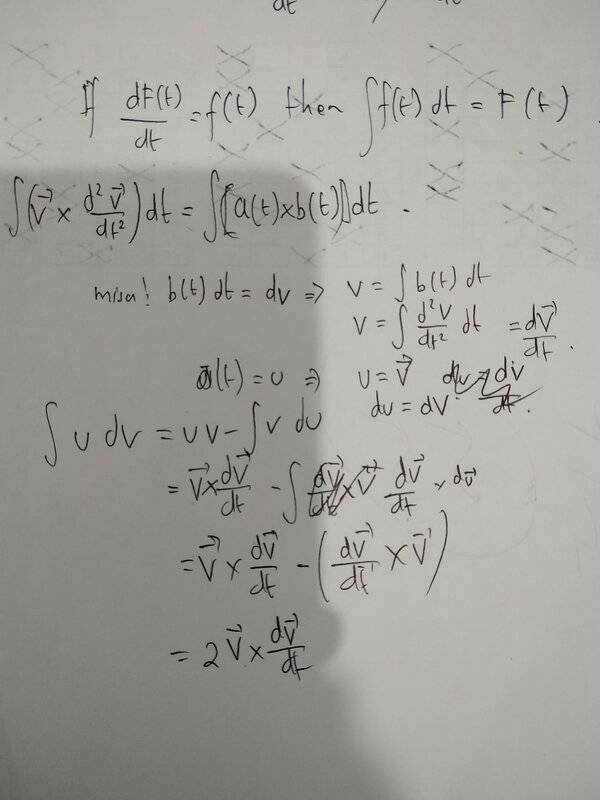

If ##\vec{v} (t)## is a vector function of t, find indefinite integral
$$\int {\left(\vec v \times \frac{d^2 \vec v}{dt^2} dt\right)}$$
Idk.
I've tried with this work in attachment. i&m not sure of my answer is correct.
The problem statement is not given properly. Can you provide us proper details? If you are computing:
$$\int v \frac{d^2v}{dt^2} dt$$​
You mentioned ##dv = b(t) dt##, and then computed ##v##:
$$v = \frac{dv}{dt}$$​
You know this is inherently not correct, unless the function is specifically ##v(t) = e^t##. Don't forget about generality when writing math proofs, or computing such things.

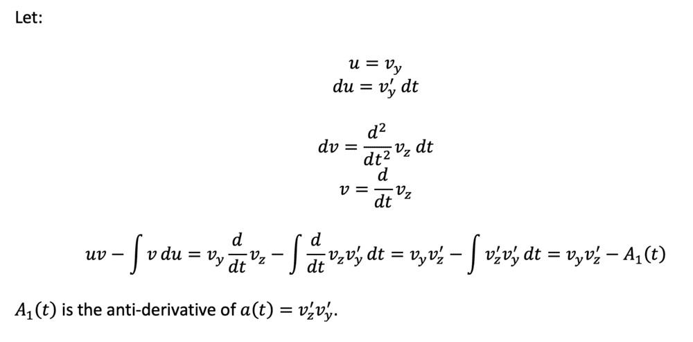

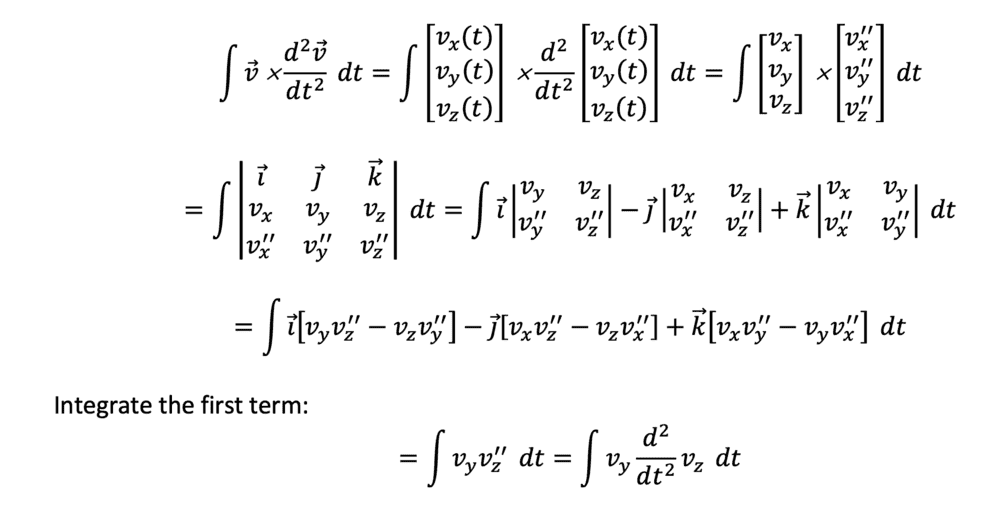

Integrate all the remaining terms, and you get a sum of antiderivatives that subtract from the other terms.
I still dislike how we use X for multiplication, and cross product every time I see it, sorry for the confusion.
@agnimusayoti , I think you confused everyone with your unfortunate choice of notation, using v (no arrow) for ##\frac{d\vec v}{dt}## and u for ##\vec v##.
Where your algebra goes wrong is in handling ##\int \frac{d\vec v}{dt}\times d\vec v##. The correct result becomes obvious if you write it as ##\int \frac{d\vec v}{dt}\times \frac{d\vec v}{dt}dt##
