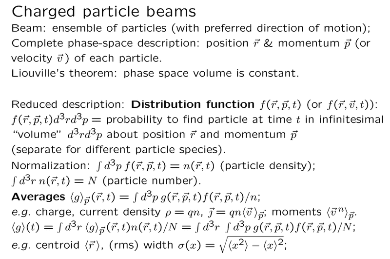

hi, so I've got this distribution function:
[tex]f(z,p,t)=\frac{1}{2\pi\partial z\partial p}exp(-\frac{[z-v(p)t]^2}{2\partial z^2})exp(-\frac{[p-p_0]^2}{2\partial p^2})[/tex]
where:
[tex]v(p)=v_0+\alpha(p-p_0)[/tex]
[tex]v_0=\frac{p_0}{m\gamma_0}[/tex]
[tex]\alpha=\frac{1}{m\gamma_0^3}[/tex]
I have to calculate the mean position as a function of time[tex]\langle z \rangle[/tex]
I've got a hint too which doesn't help me at all to be honest ;] :
All the integrals over z required to calculate the averages can be expressed in therms of [tex]I_\nu =\int_{-\infty}^{+\infty}\,ds \ s^\nu exp(-s^2)[/tex] with [itex]I_0=\sqrt{\pi}, I_1=0,\ and \ I_2=\sqrt{\pi}/2[/itex], by substitution and a suitable choice of the order of integration.
Presented function is I think distribution of particles in a beam in longitudinal phase space, and in that case
[itex]\int \,d^3p\ f(z,p,t)=n(z,t)[/itex] which is the particle density and [itex] \int \,d^3z\ n(r,t)=N[/itex] which is particles number.
So I think that mean position should look like this:
[tex] \langle z \rangle=\frac{\int\,d^3z\int\,d^3p \ z\ f(z,p,t)}{N}[/tex]
so
[tex] \langle z \rangle=\frac{\int\,d^3z\int\,d^3p \ z \ f(z,p,t)}{\int\,d^3z\int\,d^3p\ f(z,p,t)}[/tex]
am I right? if yes, how to start solving this kind of integral. I mean something like even this :
[tex] \int\,d^3z\frac{1}{2\pi\partial z\partial p} ...[/tex] those partials go before the integral .. or what?
btw. I attached two files with the actual assignment, and a slide from lecture that is supposed to tell me everything ;)

##\delta## doesn't mean ##\partial##. ##\delta z## and ##\delta p## are just constants.

Besides what Vela has pointed out to you, there is also the important issue of whether ##\delta z^2## means ##\delta(z^2)## (an "error" parameter for ##z^2##) or whether it means ##(\delta z)^2## (the square of the "error" parameter for ##z##). Using simpler symbols like ##a## and ##b## instead of ##\delta z## and ##\delta p## would be a very great help, both to you and to us. (As as genera rule, choosing simpler notation helps when dealing with lengthy and complicated calculations; often, it is a good idea to replace the problem's notation by your own before starting on the problem. Then, in the final answer you can put back the original notation. Years of experience has taught me the value of doing that!)
I'm not quite sure what is the [itex]\delta z[/itex] or [itex]\delta p[/itex]. It doesn't say, although I think that you guys are right that if [itex] f(z,p,t)[/itex] represents a distribution of particles in a beam then [itex]\delta z[/itex] and [itex]\delta p[/itex] could be the errors. Let suppose that it's acutally [itex](\delta z)^2[/itex] and [itex] (\delta p)^2[/itex] and that they're [itex]A[/itex] and [itex]B[/itex]
I'm still not sure that for example in this integral [tex]\int\,d^3z\int\,d^3p\ f(z,p,t)[/tex]
we've got [itex]\,d^3z [/itex] and [itex]\,d^3p[/itex] and if I assume that the beam goes in one direction (z) then can the integral be actually written like this? [tex]\int\,dz\int\,dp\ f(z,p,t)[/tex]

I suspect that p and z are one-dimensional, not 3-D (because you speak of a beam). If they were 3-dimensional your problem would be an uncomputable mess, because (at least for z) you would need geometric boundaries perpendicular to the beam's axis, etc.
To make further progress you need to actually use the given form of v(p), in order to reduce everything to a couple of computable gaussian-type integrations. If you start by first doing the p-integration, you need to combine all the terms having p in them, whether they come from the first factor or the second one. In other words, your p-integration may also contain z as a "parameter", and that can modify the form of the later z-integration (assuming you integrate first over p and then over z).
