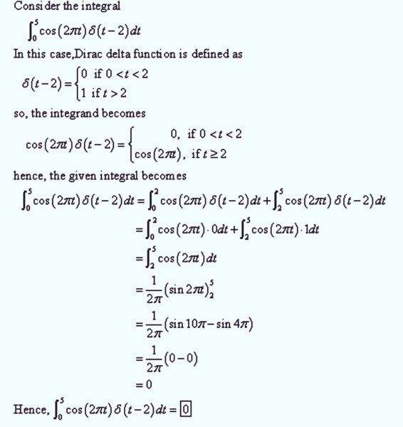

I found a solution to the first integral which totally confused me ( in the attached image) claiming that the answer should be 0 for 1st integral .
Where did you get that image? That is not how the Dirac Delta is defined...
It is a Chegg solution . And it confused me .
I believe that the first integral should be 1 , i just need more proof
I think the proof is the rule you quoted in post 3. The Chegg solution appears to be for a unit step function, not for a delta function. It's wrong.
Using the fact that $$\int_a^b f(x)\delta(x-c)dx = f(c),~\text{iff}~~a<c<b$$ we can get immediately $$\int_0^5 \cos(2\pi t)\delta(t-2)dt=\left.\cos(2\pi t)\right|_{t=2}=\cos(4\pi)=1$$
The Chegg solution is clearly wrong. The function used there is not a dirac delta function.
There is a related function, called the "Heaviside step function" or just the "step function":
[itex]x < 0 \Rightarrow \Theta(x) = 0[/itex]
[itex]x = 0 \Rightarrow \Theta(x) = 1/2[/itex]
[itex]x > 0 \Rightarrow \Theta(x) = 1[/itex]
The definition in that image seems correct for the step function, but not the delta function. The two are related by:
[itex]\Theta(x) = \int_{-\infty}^x \delta(s) ds[/itex]
I agree with Dick and Matterwave. They were defining the Heavyside function which is related to the dirac delta by:
##H(x) = \int_{-\infty}^x \delta(t) dt## or ##\frac{d}{dx} H(x) = \delta(x) ##
Edit: Got scooped by stevendaryl...Exactly.
