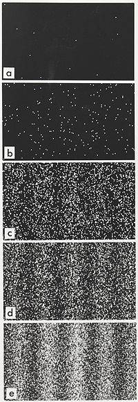

Is there a difference between EM waves and photon wavefunctions?
In summary, both photons and material particles such as electrons create analogous interference patterns when passing through a double-slit experiment. For photons, this corresponds to the interference of a Maxwell light wave whereas, for material particles, this corresponds to the interference of the Schrödinger wave equation. Although this similarity might suggest that Maxwell's equations are simply Schrödinger's equation for photons, most physicists do not agree. For one thing, they are mathematically different; most obviously, Schrödinger's one equation solves for a complex field, whereas Maxwell's four equations solve for real fields. More generally, the normal concept of a Schrödinger probability wave function cannot be applied to photons. Being massless, they cannot be
sciencejournalist00
94
Matter has a wavefunction associated to it. But what about light? Does it have both a electromagnetic wave described by Maxwell's equation and a wavefunction described by Schroedinger's equation?
Or is the electromagnetic wave considered to be the wavefunction of the photon?
I read somewhere that in interference patterns, the highest intensity peaks of a EM wave correspond to greatest probability of observing a photon. Elsewhere that photons have no wavefunction associated to them because massless particles have no position eigenstate.
Which one is true?
Intensity of EM waves = probability distribution for photon location
No wavefunction for masless particles
or
Both EM wave and wavefunction for photons
From Wikipedia
Both (photons and material) particles such as electrons create analogous interference patterns when passing through a double-slit experiment. For photons, this corresponds to the interference of a Maxwell light wave whereas, for material particles, this corresponds to the interference of the Schrödinger wave equation. Although this similarity might suggest that Maxwell's equations are simply Schrödinger's equation for photons, most physicists do not agree. For one thing, they are mathematically different; most obviously, Schrödinger's one equation solves for a complex field, whereas Maxwell's four equations solve for real fields. More generally, the normal concept of a Schrödinger probability wave function cannot be applied to photons. Being massless, they cannot be localized without being destroyed; technically, photons cannot have a position eigenstate
, and, thus, the normal Heisenberg uncertainty principle
does not pertain to photons.
