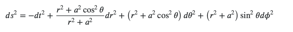

I would appreciate if someone check my work:
I tried to simplify the answer a lot: I imagined that, if we have this ds between two points different than the distance that should be if the space was flat, so it would be enough to generalize and say that space is not flat.
So, using this argument, i just analysed when ##\theta, \phi = \pi/2,0##. It would lead us to the ordinary "x" axis on the "xy plane".
So making r = 2, r =1, if the space is plane the distance between this points need to be 1.
##ds = \int_{1}^{2} \frac{r}{(r²+a²)^{1/2}}dr = (4+a²)^{1/2}-(1+a²)^{1/2} \neq 1## if ## a \neq 0##
Since a = 0 would be the ordinary spherical coordinates, the final answer is, yes, it is curved. Is it ok?

You need to do more than that. If you did a simple scaling of spherical coordinates, then the distance from ##r=1## to ##r =2## would not be ##1##.

PS You may want to check that the first term is not $$\frac{\rho^2}{r^2 + a^2}$$.

If you had the usual metric in spherical coordinates you could show the space is flat by using a coordinate transformation: $$x = r \sin \theta \cos \phi, \ y = r \sin \theta \sin \phi, \ z = r\cos \theta$$ Can you find a similar coordinate transformation here to show that this space is flat.
It's logical that if you haven't learned about curvature yet, then this space can't be curved - so it must be flat.
PS I'm still assuming it should be ##r^2 + a^2## in the denominator of the first term.
Use pluginology with p2 = r2 +a2cos2Θ. Then, try to manipulate the equation to see if it gives a multiple of the metric tensor in the basis of the spherical coordinates ds2 = dr2+ r22 + r2sin2θdφ2

Do you have a solution with ##\rho^2 + a^2## in that first denominator? I think that should be ##r^2 + a^2##.
I haven't worked out the solution, but I think you are correct.
Swapping the denominator gives the Kerr metric, in the limit Mass → 0, which becomes a flat space.
