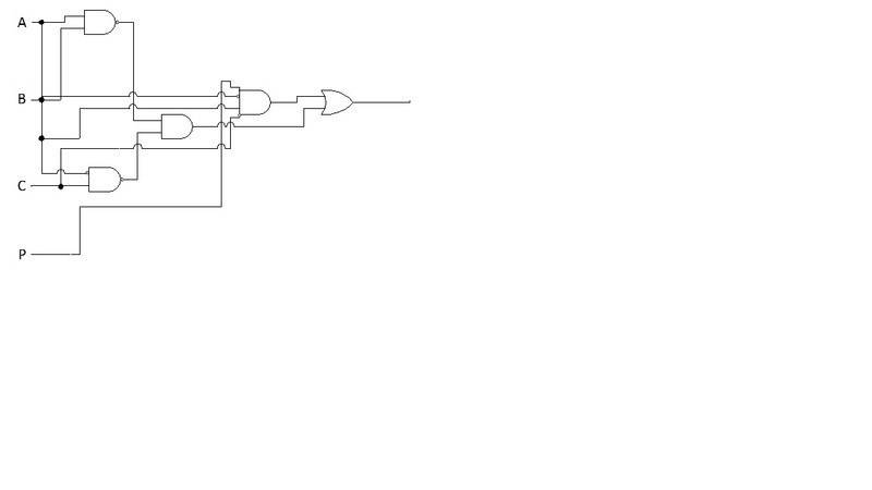

In summary, the boolean expression I am working with is: ((ab)'(b'c)' + a'bpc') where ' is the NOT symbol.
ibcoding
The boolean expression I am working with is:
I have the following logic circuit diagram. Is it correct?
Welcome to PF!
The diagram is confusing a bit, because one of the a lines is very close to one of the b lines. However it looks correct to me.
Ok, I know exactly which line you are talking about; I thought the same thing. I'll change that around. Thanks!

Alright, variable p is missing from that equation, but I get the idea. On that note, is this the correct truth table outputs:

Ahh, the a' a' are adjacent so it is absorbed, got ya
So the equation should be a'(b + c') + b'pc'
which gives me three and gates and two or gates

Sorry, I wasn't complaining. :) Alright, that's the same as what I have.
The equation breaks down to a'b + b'c' + a'bp, I believe.
