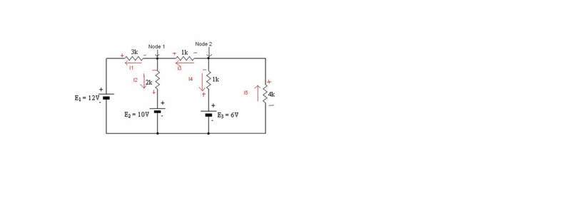

1) Using Kirchoff's Laws, find all the currents flowing in the cct.
2) Hence, determine the voltages across all resistors and check that each loop complies with KVL

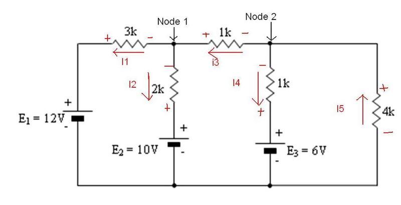

You need to write 2 KCL equations and 3 KVL equations in this circuit to solve it.
You will get 5 unknown currents (through 5 sections of the circuit) in 5 linear equations.
**You can't take the equivalent R here.
Basically you can take the equivalent of a pair of elements only if you know that they have either the same voltage or the same current going through them, this is not the case in this circuit.
Does it make any sense?
i think so but i am unsure about directions because i have not seen 3 voltage sources used before: Here's what i came up with if you could suggest if this is correct:
KCL at node 1: -I1 -I2 + I3 = 0
KCL at node 2: -I3 -I4 + I5 = 0
KVL (left) : 12 - (I1*R1) + (I2*R2) - 10 = 0
KVL (middle): 10 - (I2*R2) - I3*R3) + (I4*R4) - 6 = 0
KVL (right): 6 - (I4*R4) + (I5*R5) = 0
Please see image for resistor and current labels and directions

just hoping this cct looks better

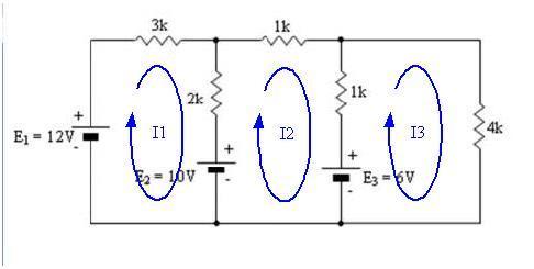

You only need to write three KVL equations covering the three loops.
Be sure to "walk" all the way around each loop and include all currents flowing in each component.
ok thanks but where have i gone wrong in the three eqns i posted?
Would i rewrite as :
Loop 1: 12 - I1R1 + (I1 - I2)R2 - 10 = 0
Loop2: 10 - (I1 - I2)R2 - I2R3 + (I2 - I3)R4 - 6 = 0
Loop 3 : 6 - (I2- I3) + I3R5 = 0 ?
Be careful about the directions of the currents in the components to maintain consistency. For loop 2, I2 going through the 2k resistor R2 should be a voltage drop, while I1 going in the opposite direction through the 2k would be a voltage rise. So
Loop 2: 10V - (I2 - I1)R2 - I2R3 - (I2 - I3)R4 - 6V = 0
Do the same for Loops 1 & 3.
so does this look right:
Loop 1: 12 - I1R1 - (I1-I2)R2 - 10 = 0
Loop 3: 6 - (I3-I2)R4 - I3R5 = 0
with loop 2 given in your last post
That looks okay to me. Solve for the currents and let's see what you get.
