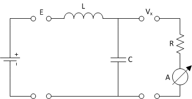

C = 4 μF
L = 0.2 Hy
E is DC current. No internal resistance.
Write an expression the the laplace plane transfer function, that relates current (that flows through resistor R) to the voltage E.

I'm having a little trouble interpreting your problem statement.
I suspect that something like this drawing is intended.
If that is the case, then your expression for the Laplace transfer function is correct, assuming it applies to the circuit in the middle.
Your current through R would follow from that, but it would only be correct if we can assume that this current is much smaller than the other currents.
(Btw, I just got a new drawing program on my computer, so I just had to make a drawing. :wink:)
Are you attempting to back-engineer the circuit from the information stated?
(Write an expression for the Laplace plane transfer function)
So rude man was wrong, and I did use voltage divider correctly?
And yes my exercise is like the one you drew.

First off, a transfer function is a ratio of output to input in the Laplace domain. Your problem does not state whether to treat the current as input or the voltage as input. We will assume the problem meant for E to be the input.
The problem does not state to assume initial conditions are zero, so these will be part of the solution. We can do mesh analysis:
[tex]-E(s)+LsI_1(s)-Li_1(0^-)+\frac{I_1(s) -I_2(s)+v_C(0^-)}{Cs}=0[/tex]
[tex]\frac{I_2(s)-I_1(s)-v_C(0^-)}{Cs}+I_2(s)\left(R+A \right)=0[/tex]
Use these coupled equations to solve for the ratio
[tex]\frac{I_2(s)}{E(s)}[/tex]

No KCL or KVL with L's and C's? Oh dear.
But, all is not lost:
1. calulate Z1 = parallel combination of your R and C.
2. Now Vx = E*Z1/(Z1+ sL).
3. Then i = Vx/R.
You did not state the problem completely at all. If S is closed at t=0, what is the Laplace representation of E? And oh yeah, someone's got to give you the value of R sometime ...

Here's an idea: I anticipated the second part of her question, which undoubtedly is to determine i(t) in the resistor. Seeing as E is shown to be a dc source with a switch S ... make sense?
The OP was badly misled from the start by her leaving out the effect of R on her voltage divider. That should be the thing for her to correct, not start her on a treatise on how to write KVL and KCL equations using transformed impedances. She does that one thing, she' practically home free.

For the second diagram, you made a typo in the denominator - it should be (1/sC)||R + sL.
Then, I = ({(1/sC)||R}/{(1/sC||R + sL})(E/R).
I can give you the correct expression for the first diagram, but you'll have to figure out if it's the same as yours: E/I = sL/(s2LC + 1) + R

But won't these equations only find me the current over Ls?
In order to find the current at R I need to do this:
http://img17.imageshack.us/img17/497/transfuncccc.jpg
Yup. :)
(Don't forget the s after L in the first line.)
