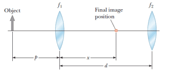

Two converging lenses having focal lengths of f1 = 12.5 cm and f2 = 19.5 cm are placed a distance d = 49.0 cm apart as shown in the figure below. The image due to light passing through both lenses is to be located between the lenses at the position x = 33.0 cm indicated. (a) At what value of p should the object be positioned to the left of the first lens? (b) What is the magnification of the final image? (c) Is the final image upright or inverted? (d) Is the final image real or virtual?

The magnitude seems reasonable, my problem is the sign. I followed the sign convention so why isn't this value positive? Object distance (p) is positive when the object is in front of the lens.

49 - 16 = 33, the x position given in the question. So this is the correct answer. I figured I would post it in case someone else gets this problem.

I agree with your answer p = 18.1 cm

You can show that if the object distance of a converging lens lies between f and 2f, then the magnification will be greater than 1. I agree with your value of m here.
M = -Q/P
Q in this case is negative, so:
M = Q/P
Q is negative. But you should still write M = -Q/P. Then M will be positive, as it should be in this case. Remember Q = -16 cm, so you should plug in -16 cm for Q.
Nevertheless, I do agree with your answer M = 1.82.
Shouldn't this also be less than one?
If I'm not mistaken, the image size decreases each time. Greater than one image magnification on either lens seems inconsistent with this.
Note that the second lens is acting like a magnifying glass. It's magnifying the image of the first lens.
Total Magnification = 4.06
m is negative while M is positive. So, what should be the sign of the overall magnification?
