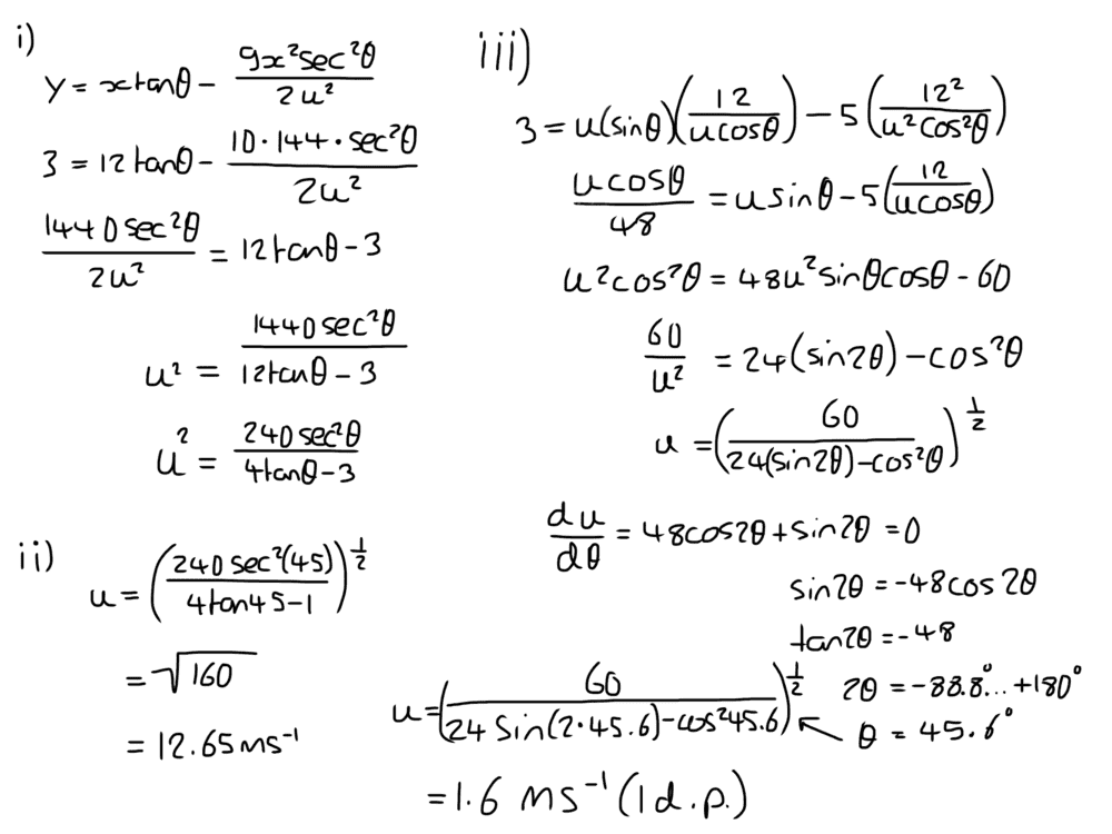

A child is attempting to throw a ball over a wall of height 5m that is 12 m away. The ball is thrown at a speed of u ms^-1 from a height of 2m, at an angle theta to the horizontal. Assume g = 10 ms^-2.
i)
If the ball just clears the wall use the Cartesian equation of trajectory to find an expression for u^2 in terms of tan(theta).
ii)
Find u when theta = 45°
iii)
By differentiating a multiple of u^2 or otherwise, find the minimum speed at which the ball can be thrown in order for the wall to be cleared, and the angle at which it must be thrown.
I think I have the correct answers for the first two. I followed the method in this link https://www.youtube.com/watch?v=cZiA4U4QRZg for the last, using differentiation to find the min velocity, but the angle comes out very close to 45° like (ii), but the velocity is much lower. Think it may be because the question in the link has ball starting on the ground, whereas in the question above it is 3m above the ground. I inputted y = 5-2 = 3 into the Cartesian equation, maybe this is wrong? Or I have rearranged and differentiated the equation wrong.
Thanks
Cartesian equation of trajectory:
y = xtanθ - (gx[SUP]2[/SUP]sec[SUP]2[/SUP]θ)/2u[SUP]2[/SUP]
Attempt at solution in attachment.

Is your final answer ##1.6m/s##?
Yes that is my final answer
That's going to clear a wall ##12m## away? That speed has a maximum range of about ##25cm##.
PS for (i) you dropped a factor of ##2## in your equation for ##u^2##. And it does say ##\tan \theta##, so I would convert the term in ##\sec^2 \theta##.
Likes etotheipi
Exactly, that’s the problem with the answer. The value of u for (ii) was 12.6 ms^-1, at an angle of 45. 1.6 is way lower. I got this value by following the method in the link I included in the statement, which seems to work for them. I want to solve it by differentiation, as in the link, but don’t know where I‘m going wrong.

That looks right for (ii). Let me have a look at (iii).
That differentiation is a bit tricky. You must have made a mistake. One idea is to differentiate with respect to ##\tan \theta##. We have:
$$v^2 = \frac{gx^2(1 + \tan^2 \theta)}{2(x\tan \theta - y)} = \frac{gx^2(1 + \alpha^2)}{2(x\alpha - y)} = f(\alpha)$$
You need to minimise ##f(\alpha)##, where ##\alpha = \tan \theta##. Note that minimising ##v^2## is the same as minimising ##v##.
That should make the differentiation less tricky.

It looks like you managed to get the ##\frac{gx^2}{2}## mixed up in the derivative somehow. It's just a constant, so it should have stayed out front. If you want to be even cleverer, you need to minimise:
$$\frac{(1 + \alpha^2)}{(x\alpha - y)}$$
Leaving out the values I get:
(xα - y)(2α) - (1 + α^2)(x) / (xα - y)^2 = 0
xα^2 - 2yα - x / (xα - y)^2 = 0
not sure how to simplify this, unless I can multiply both sides by denominator to get rid of it.

That's good. You want to set ##f'(\alpha) = 0## for the minimum. You only need to look at the numerator for that.
Can quadratic formula be applied to this since there are 2 x expressions In the numerator a = c ?
Yes, exactly. You have a quadratic in ##\alpha## with ##x, y## as constants.
α = 2y ± sqrt((-2y)^2 -(4x)^2 / 2x
Does that look right
Not quite. Watch your signs. ##\alpha = \tan \theta > 0##, so you have only one solution:
$$\alpha = \frac{y + \sqrt{x^2 + y^2}}{x}$$
You can plug that back into the formula for ##v^2## now. Things do simplify!

I used the quadratic formula correctly! We have:
$$x\alpha^2 - 2y \alpha - x = 0$$
So, ##a = x, \ b = -2y, \ c = -x##
$$\alpha = \frac{-b \pm \sqrt{b^2 - 4ac}}{2a} = \frac{2y \pm \sqrt{4y^2 +4x^2}}{2x} $$

The easiest way to differentiate [tex]u^2 = K\frac{1 + \alpha^2}{x\alpha - y}[/tex] is to multiply by [itex]x\alpha -y[/itex] and then differentiate, to obtain [tex]
2u\frac{du}{d\alpha}(x\alpha - y) + u^2 x = 2K\alpha[/tex] and since [itex]\frac{du}{d\alpha} = 0[/itex] you have immediately [tex]
u^2 = \frac{2K\alpha}{x}[/tex] which yields [tex]
\alpha^2 - 2\alpha \frac{y}{x} - 1 = 0[/tex] which is readily solved for [itex]\alpha[/itex].
Likes PeroK
Just to wrap this up. We get:
$$\tan \theta = \frac{y + \sqrt{x^2 + y^2}}{x} = \frac{y + d}{x}, \ \ \ v^2 = g(y + \sqrt{x^2 + y^2}) = g(y + d)$$
Where ##d## is the total distance to the target.
Got it. Thanks for the help.
