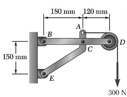

Dont really need the answer, but I want to know if point C has Cx and Cy or just Cy. I am confused there.
Pinned connections generally take two force components, since they can support a force applied in any direction.
As a suggestion, find the equivalent forces to substitute on the frame for the weight suspended by the wire running over the sheave at pin D.
