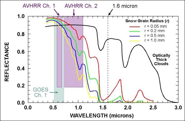

  • #65
sylas said:
Water most certainly is a strong greenhouse gas, and that is a major reason why clear nights are colder.
Eh, I have to disagree with the underlined portion (and only with that; I agree with the thesis statement). Cloud cover is an excellent reflector of IR; this works in both directions, obviously. At night, with little incoming energy, the ground and everything on it radiates its usual blackbody spectrum, peaking in the IR. On clear nights, this IR just mostly passes through the atmosphere, with a small portion being absorbed and re-radiated by various atmospheric gases--nothing special here. However, on cloudy nights, the ground-radiated IR is largely reflected from the cloud bottoms back down to the ground where a percentage of it is subsequently re-absorbed; the warmer ground heats the air above it and, voila, you've got a warmer-than-expected night. No greenhouse property of water vapor (which I agree is a real effect, don't get me wrong) is required.
  • #66
My understanding is that the effect you are describing is not "reflection", but absorption and re-emission of radiation... and that is a greenhouse effect. Clouds are good at this because they are made of water.
But I'll check a bit further.
Thanks -- sylas
  • #68
That's what reflection is thought to be, at a fundamental level. However, clouds are not water vapor, but liquid water droplets. These are MUCH better at reflecting light, including IR, than water vapor (or any transparent gas, for that matter).
  • #69
Actually reflection is a much different process, and sylas is right that it is not an important term for Earth's clouds (in the IR, obviously this not apply in the visible). In a lot of planetary applications though (like early Mars, Venus) scattering of IR light is very important. And water vapor or clouds are both very important considerations, whether it be day or night.
  • #70
I don't believe this is correct. See the following chart:
