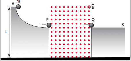

A particle of mass M, with charge Q is left at the point A. After reaching point P the particle is at the effect of a constant and uniform magnetic field of intensity B reaching point Q.
Find H.
P=mg
Fm=qvB
Ke=(mv^2)/2
U=mgH
The big problem is not solving this question, because I was able to do that, but I didnt understand why during the trajectory from P to Q the particle has no gravitational potential energy.
The solution:- During the trajectory from P to Q the direction of the movement doesn't change so the magnetic force must cancel out with the weight of the particle.
So, using conservation of energy we get that:
This is the right answer but I am still confused.

If the magnetic force exactly opposes gravity, what is the trajectory of the particle across the gap? What is the change in gravitational potential energy?
It would be a circular motion since the magnetic force would be perpendicular to the trajectory of the particle.

You know that the velocity is to the right and that the magnetic field is out of the screen. The magnetic force is given my ##\vec F_M=q \vec v \times \vec B##. Use the right hand rule to find its direction. If the particle is positive, you get one direction (what is it?) and if it's negative, you get the opposite direction. Which of the two directions makes sense in view of the given fact that the particle makes it across the gap?
If the particle is positive the direction would be the same as the weight, so since it makes it ouf of the gap it can onby be negative, the magnetic force would be pointing upwards, and the weight would be pointing downwards, the centrifugal acceleration would be in the same direction as the centrifugal resultant force.

How about drawing a picture of the path that the particle describes in the gap? It has to start at point P with horizontal velocity ##\vec v## to the right and end up at Q still moving to the right with horizontal velocity as suggested by the drawing you posted. What kind of line would connect points P and Q?
I think it would probably would be a semicircunference with an arc upwards.

The problem statement contains a blunder. H ought to be specified as the starting height above points P and Q.
Also, the slope should be given as frictionless, or some KE will go into rotation.

Clearly that is a solution to the problem. if released at exactly the right height the velocity will be such that the two forces cancel.
If we assume the problem is well posed (apart from the blunder) then there are no other solutions.
If you do not wish to make that assumption, can you show there are no funny loop-the-loop solutions?

My problem isn't exactly with solving it, but my question comes from the fact that, in the second step of my solution, I didnt need to consider the gravitational potential energy of the body traveling from P to Q while equating the mechanical energies, and I don't understand why I can do that.

Look at the equation you posted in #1, ##q v B = m g##. It says that the magnetic force (up) is equal to the gravitational force (down). If that's the case, the net force is zero, the particle travels in a straight line and keeps traveling in a straight line. Because the straight line is horizontal, there is no change in gravitational potential energy. Even if the particle went from P to Q following some other path, the change in gravitational potential energy would still be zero because there is no vertical height change.

I believe I can show that other solutions only exist if the width PQ is a multiple of ##2\pi g(\frac{m}{qB})^2##. For those widths, the height of the descent can be anything, provided PQ is sufficiently high above the ground.

I understood, but the comparison is between the particle at point A and at a random point during the motion from P to Q, and during this the particle still has some height from the black line that is used as H`s referential, as I understand it the gravitational potential energy would be equal to the work needed to bring that particle from the "ground" to the height h where it is at against the gravitational acceleration g, I still don't get why it would be 0.
Potential energies are always relative. You can set your ground level wherever you like.
As I noted, the question as given makes no sense. You cannot find the value of the H in the diagram. H ought to have been defined as the height the particle starts above the PQ level. So it is logical to set the PQ level as your reference. That makes the GPE zero there.

Oh, right. A sag in the trajectory cannot proceed infinitely downward with a radial acceleration that scales directly with velocity. Then symmetry assures us that the eventual high point must be level with P. So it is clear that the trajectory is periodic and the only difficulty is tuning the period.

Yes, it's very interesting. The motion is the sum of a constant horizontal velocity and a circular motion at constant rate. Varying the entry speed changes the radius but not the period nor the horizontal 'drift' velocity.
