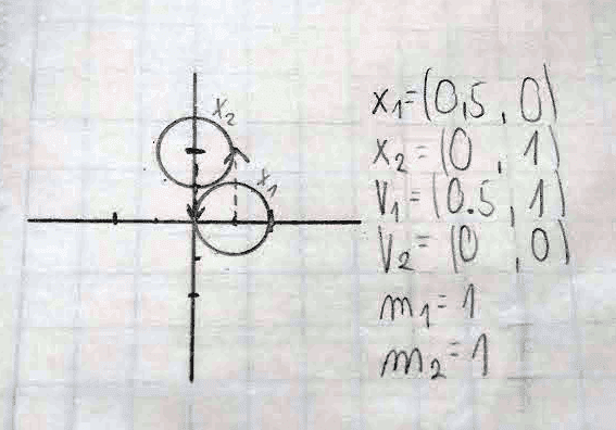

my values are :
x1 = (0.5 , 0)
x2 = (0 , 1)
m1,m2 = 1
v1 = (0.5, 1)
v2 = (0, 0)
[/B]
And here its my solution with vector (0.835 , 0.329), but this result can't be correct can somebody help me what I am doing wrong ? My result is total wrong and i don't know why

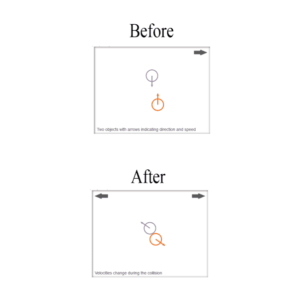

When i simulate my example on some online calculators then vectors must look like this for my parameters
But my final vector after collision its going to wrong direction :(
Hogwash: there ##\vec v_2\ne0##
