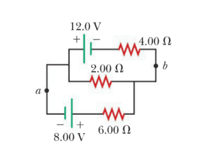

http://file:///Users/jarrettwingfield1/Desktop/Screen%20Shot%202016-09-29%20at%205.29.21%20PM.png My professor told me my equations were correct, but I do not know how to find the current through each resistor mathematically, and every example I find online is too simple so it doesn't help me.
My equations are: i1=i2+i3; -2i2 - 6i1 = -8 ; 2i2- 4i3 = -12
An online calculator says i1=0.857 i2=-1.429 and i3= 2.286

I attached the problem and my work. Where it says 3(4), that just means I multiplied equation 3 by 4, to add to the equation of 1+2
