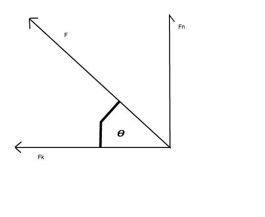

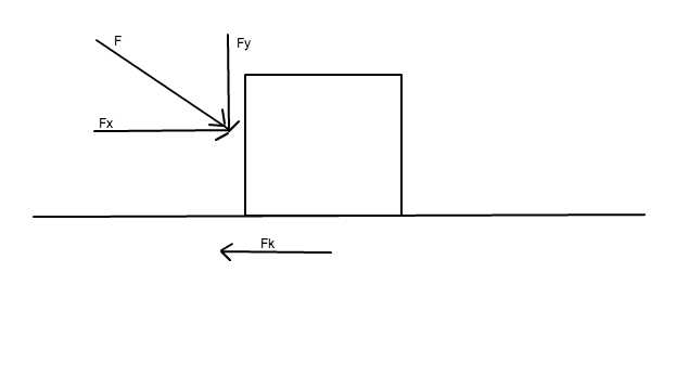

##F_y=F*sin(\theta)##
##F_x=F*cos(\theta)##
##F_n-F_y = 0## Forces in y-direction
Due to the constant velocity the forces in the x-direction ##F_x-F_k = 0##
##\theta## is the angle between F and ##F_x##.
The result force diagram will look like the picture above, from there it is just geometry.

That looks "Almost" the same as mine. The only difference is that I included a vector for the Weight of the box. That also seems to be where my problem came from.
Can you tell me why you didn't include the weight of the box?
I'm pretty certain that is my mistake. I just don't understand why it should be excluded?
