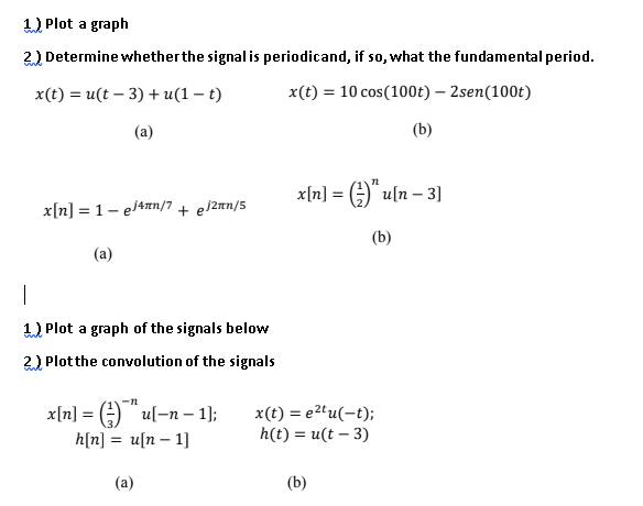

I am solving a work of signs and systems and asked me to find in the equations below the graph and the fundamental period
And in question 2 asks to plot the graph of the signs and also the convolution.
a)
x(t) = u(t-3)+u(1-t)
b) x(t) = 10cos(100t)-2sen(100t)
c) x[n] = 1- e^j4pin/7 + e^ j2pin/5
d) x[n] = (1/2)^n u[n-3]
2)
a) x[n] = (1/3)^n u[-n-1]
h[n] = u[n-1]
b) x(t) = e^2t u(-t)
h(t) = u(t-3)
I do not know how to declare time t and unit steps.

The image of problems to get a better understanding as well.
I can solve 1a and 1b, but I could not figure out if a function is periodic or not.
Both were like this ...
a)
t = (-10:0.01:10);
x1 = t>=3;
x2 = t<1;
xtot=x1+x2;
plot(t,xtot)
axis ([-10,10,0,1.2])
b)
t = (-0.5:0.001:0.5)';
x1 = 10*cos(100*t);
x2 = 2*sin(100*t);
xtot=x1-x2;
plot(t,xtot)
axis ([-0.5,0.5,-11,11])
Is the cosine function periodic? What is its period?
Yes, I completed question number 1.
The letter A is not periodic and B is!
Your approximate period by the graph that MatLab gave me is something around 0.7.
