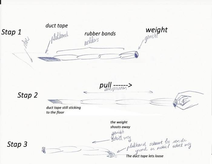

Hi, I'm a second year Design Engineering student. This year we're having some basic physics class. We're doing projects on potential energy at this moment. I'm having a problem with the following;
The assignment:
The teacher assigned us that only 6 Joules of potential energy may be used to make a contraption move as far as possible, this can be anything, a car, a paper plane, etc..
1. Homework Statement
I connected 5 rubber bands in series with on one side a weight (15 grams), on the other side some duct tape.
The duct tape sticks to the ground while the weight is being tentioned. I let loose of the weight and the whole contraption (including rubber bands and duct tape) shoots away.
I need to get to know the potential energy of a shot.
[/B]
I calculated the spring constant by hanging a bottle of with water (545 grams) to the rubber bands in series, the rubber bands stretched out 25cm (50cm - 25cm)
F= kx
k= F/x
k= 5,5N/0,25
k= 22Nm
[/B]
Then I calculated the PE. This is my ACTUAL PROBLEM, I'm very sceptic about this one because it's seems too little.. (I'm not the best with physics or maths)
PE= 1/2*k*x²
PE= 0,5*22Nm*(0.25m)²
PE= 0,6875 J
A picture of the setup
Is this a realistic/plausible result?
Am I doing this right?
The rubber bands I'm using are the typical office rubber bands.
It would be nice if someone could help me out with this one.Thank you.
Where you wrote Nm for the spring constant units, you mean N/m. Other than that, your working looks correct. The result is reasonable. In descending 0.25m the bottle lost a bit over 1J of gravitational PE. If allowed to fall freely it would have had some KE at the equilibrium point, so the PE in the elastic at that point must be less than 1J (in fact, half the lost gravitational PE).

Thanks for your answer, I really appreciate it!Another thing popped up in my head now.
Does the fact that the rubber bands are in series makes any difference?
I'm also wondering if there's any way to calculate the the best ratio of maximum travel distance and amount of rubber bands?
Adding more bands gives the contraption more power, but also adds lots of friction.
Perhaps I should stay with 5 ~ 7 bands and stretch it as far as I can?
Thank you

It affects the spring constant. You should be able to work out in what way.

Isn't the serie of rubber bands acts as one big band?
Yes, but the spring constant changes. If I put two springs of constant k in series and apply a tension T, what will the total extension be? What does that make the spring constant for the combination?

No, it was about right, though it could be a little more accurate. I guess you took g = 10ms-2, not 9.8. Keep at least 3 significant figures through the working.
